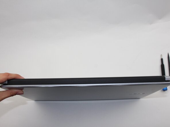

    • For safety, unplug all connected devices and accessories.
    • Discharge the battery below 25% and power down your Chromebook.
    • Close the lid.
    • Position the laptop so the hinge, or the part connecting the screen and keyboard, is facing you.
    • Caution: Working with a charged battery can cause short circuits. Always make sure the device is powered off.

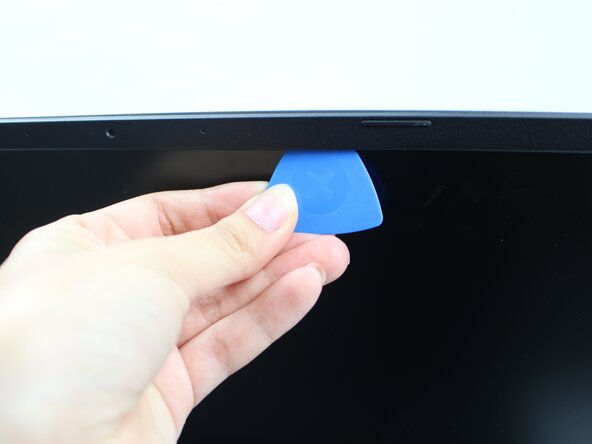

    • Insert an opening pick into the gap between the screen and the plastic bezel.
    • Gently slide the pick along the edge to separate the two parts.
    • You may have to use light force.
    • Repeat this process around the entire border of the screen.
    • Once loosened, carefully pull off the bezel with your hands.

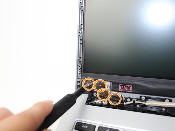

    • Use the Philips #1 screwdriver to remove the two 5mm screws located in the top corners of the screen.
    • Use the Philips #1 screwdriver to remove the two 5mm screws from the bottom left and right corners of the screen.

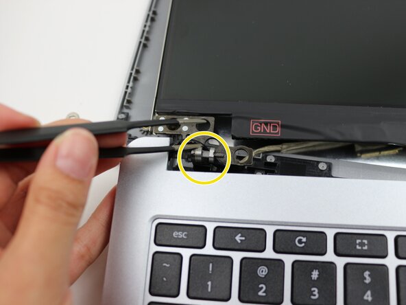

    • Use the tweezers to remove nuts and washers securing the screen to the hinges.

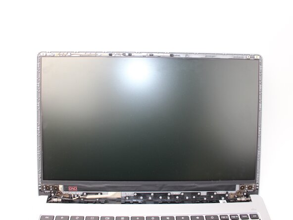

    • Carefully lift the display panel away from the hinge that connects it to the keyboard.

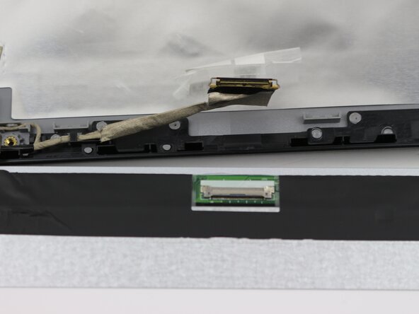

    • Locate the display cable on the back of the screen.
    • Peel off the tape covering the small metal latch that secures the cable connector.
    • Gently lift the latch using your finger or a spudger to unlock it.
    • While holding the latch, gently pull the cable straight out of the socket.
    • Avoid pulling on the cable itself. Grip the connector to prevent damage.
