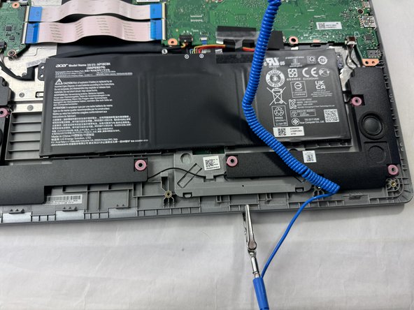

    • Always wear an anti-static wrist strap when working with an electronic device, as static electricity from your hand could damage it.
    • To use the anti-static strap, attach the strap to your wrist and then attach the end of the cord to something that is also metal, preferably something in your Chromebook. This strap will discharge any static electricity that you build up instead of it going into the metal parts of your computer, which could damage the components.
  5. Acer Chromebook CB315-3HT-C3FQ Speaker Replacement, Speaker: crwdns2935265:05crwdnd2935265:01crwdnd2935265:03crwdne2935265:0 Acer Chromebook CB315-3HT-C3FQ Speaker Replacement, Speaker: crwdns2935265:05crwdnd2935265:02crwdnd2935265:03crwdne2935265:0 Acer Chromebook CB315-3HT-C3FQ Speaker Replacement, Speaker: crwdns2935265:05crwdnd2935265:03crwdnd2935265:03crwdne2935265:0
    • Unplug the speaker cord from the motherboard's port.
    • Remove the speakers from the laptop.
    • Scan the QR code located in between the left and right speakers. The QR code will take you to different sites that sell the internal speakers that are for the Acer Chromebook 315.
