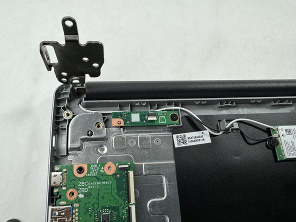

  7. Acer Chromebook CB315-3HT-C3FQ Daughterboard Replacement: crwdns2935265:07crwdnd2935265:01crwdnd2935265:02crwdne2935265:0 Acer Chromebook CB315-3HT-C3FQ Daughterboard Replacement: crwdns2935265:07crwdnd2935265:02crwdnd2935265:02crwdne2935265:0
    • Lift up the metal hinge.
  8. Acer Chromebook CB315-3HT-C3FQ Daughterboard Replacement: crwdns2935265:08crwdnd2935265:01crwdnd2935265:01crwdne2935265:0
    • Remove the daughterboard from the laptop.
