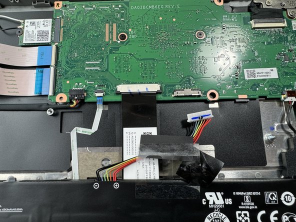

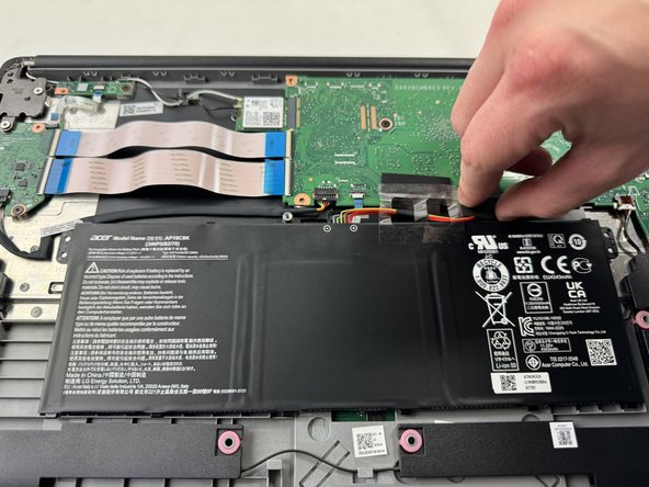

  5. Acer Chromebook CB315-3HT-C3FQ Battery Replacement, Battery: crwdns2935265:05crwdnd2935265:01crwdnd2935265:02crwdne2935265:0 Acer Chromebook CB315-3HT-C3FQ Battery Replacement, Battery: crwdns2935265:05crwdnd2935265:02crwdnd2935265:02crwdne2935265:0
    • Remove the thermal tape that covers the wires connecting the battery to the motherboard.
    • Move the thermal tape to the side so you can put it back on afterwards.
  6. Acer Chromebook CB315-3HT-C3FQ Battery Replacement: crwdns2935265:06crwdnd2935265:01crwdnd2935265:02crwdne2935265:0 Acer Chromebook CB315-3HT-C3FQ Battery Replacement: crwdns2935265:06crwdnd2935265:02crwdnd2935265:02crwdne2935265:0
    • Unplug the bundle of wires that connect the battery to the motherboard.
    • Remove the battery from the laptop.
