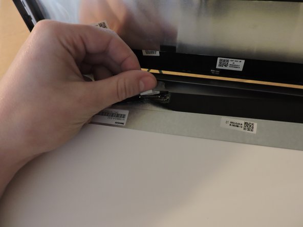

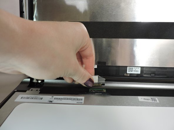

  3. Acer Chromebook CB3-532-C47C Screen Replacement: crwdns2935265:03crwdnd2935265:01crwdnd2935265:03crwdne2935265:0 Acer Chromebook CB3-532-C47C Screen Replacement: crwdns2935265:03crwdnd2935265:02crwdnd2935265:03crwdne2935265:0 Acer Chromebook CB3-532-C47C Screen Replacement: crwdns2935265:03crwdnd2935265:03crwdnd2935265:03crwdne2935265:0
    • Peel off the tape securing the screen cable and pull the cable off the screen.
    • Remove the screen.
