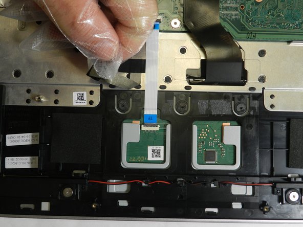

    • Remove the black tape covering the screws connecting the trackpad to the laptop.
  8. Acer Chromebook CB3-431-C5EX Trackpad Replacement: crwdns2935265:08crwdnd2935265:01crwdnd2935265:01crwdne2935265:0
    • Remove the three 2.5 mm screws that are securing the trackpad to the laptop using a Phillips #0 screwdriver.
  9. Acer Chromebook CB3-431-C5EX Trackpad Replacement: crwdns2935265:09crwdnd2935265:01crwdnd2935265:02crwdne2935265:0 Acer Chromebook CB3-431-C5EX Trackpad Replacement: crwdns2935265:09crwdnd2935265:02crwdnd2935265:02crwdne2935265:0

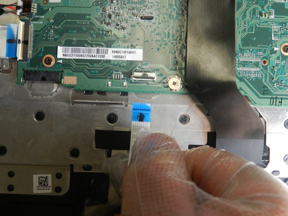

    • Lift up the black retaining flap on the connector.
    • Slide the blue ribbon cable out of the connector.
  10. Acer Chromebook CB3-431-C5EX Trackpad Replacement: crwdns2935265:010crwdnd2935265:01crwdnd2935265:01crwdne2935265:0
    • Lift up the body of the laptop and slide the trackpad out from beneath.
