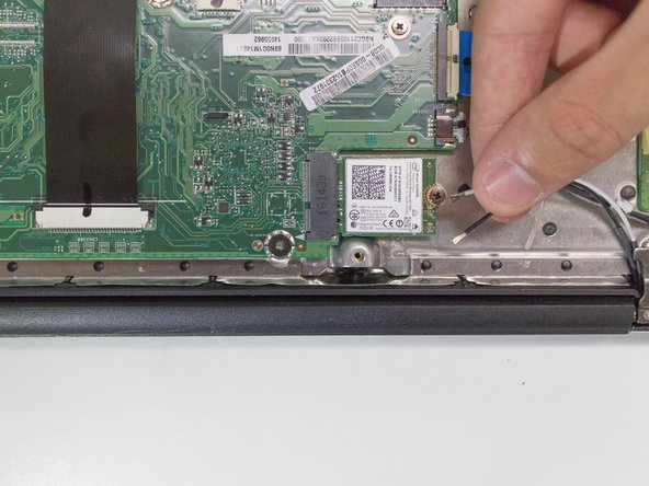

    • Disconnect black and white wires from the wireless adapter by gently pulling up on the metal connectors with your fingernail.

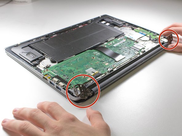

    • Open hinges to the screen. and then slide base of the computer off of the hinges.
    • It is easiest to do this by holding the hinges in place and opening the entire laptop. Then close the laptop while letting the hinges remain open.
    • This will detach the base of the computer from the screen in order to allow better access to the power port.

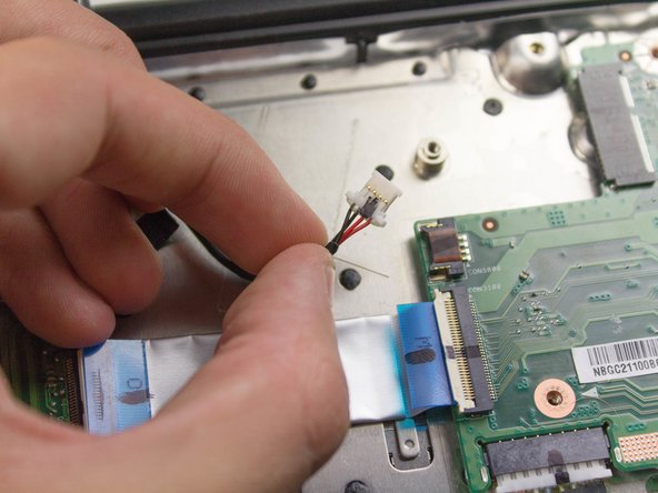

    • Detach the power port plug from the main circuit board by grabbing it by the sides of the plastic with the tweezers and gently pulling it out.

However, a word of advice. If you do want to disconnect the wires be warned that their terminals are extremely small and difficult to get back if damaged. It appears to be a soft metal and if you do not line them up exactly the holes on the wireless chip will distort and you will find it impossible to put them back on. I speak from experience and the only solution is to either buy a new wireless adaptor or to solder the wires on.
That itself is fiddly and I have yet to find out if it has worked on mine. (I need to buy a soldering iron). As the wire is an antenna only, I am assured that it should still work even without a connection, provided that you are near the router.
My recommended procedure is not to disconnect the wires but instead to take the small screw out of the adaptor itself and then press down and slide it out. That will free the two halves of the computer without separating the wires.
