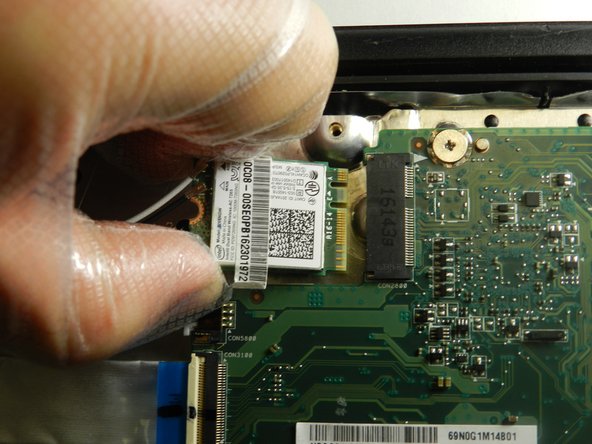

    • Remove the 4.7 mm screw from the Wi-Fi card using a Phillips #0 screwdriver.
    • Remove the Wi-Fi card from the laptop.
