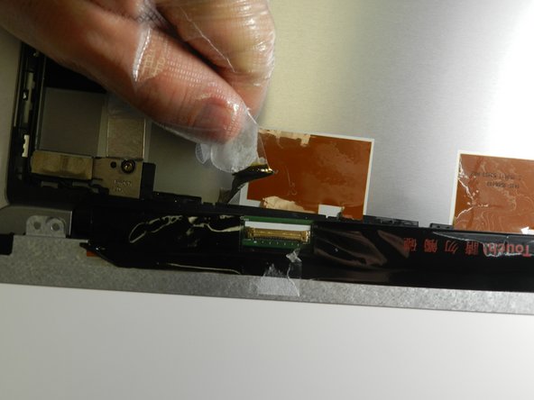

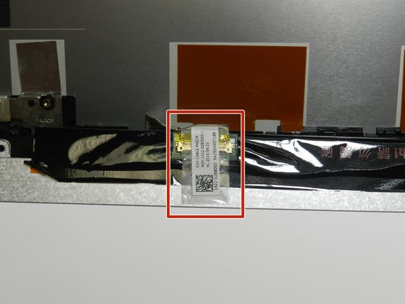

  4. Acer Chromebook CB3-431-C5EX Display Replacement: crwdns2935265:04crwdnd2935265:01crwdnd2935265:03crwdne2935265:0 Acer Chromebook CB3-431-C5EX Display Replacement: crwdns2935265:04crwdnd2935265:02crwdnd2935265:03crwdne2935265:0 Acer Chromebook CB3-431-C5EX Display Replacement: crwdns2935265:04crwdnd2935265:03crwdnd2935265:03crwdne2935265:0
    • Gently lay the screen against the keyboard.
    • Carefully remove the adapter connecting the display to the motherboard.
  5. Acer Chromebook CB3-431-C5EX Display Replacement: crwdns2935265:05crwdnd2935265:01crwdnd2935265:01crwdne2935265:0
    • Once you have separated the screen from the motherboard, carefully remove the display from the laptop.
To reassemble your device, follow these instructions using a replacement screen, in reverse order.
