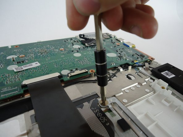

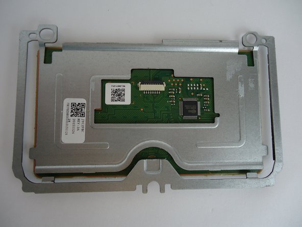

  6. Acer Chromebook CB3-131-C3KD Track pad Replacement, Trackpad: crwdns2935265:06crwdnd2935265:01crwdnd2935265:02crwdne2935265:0 Acer Chromebook CB3-131-C3KD Track pad Replacement, Trackpad: crwdns2935265:06crwdnd2935265:02crwdnd2935265:02crwdne2935265:0
    • Remove the (3) three 7.0mm screws using the J0 screwdriver head.
  7. Acer Chromebook CB3-131-C3KD Track pad Replacement: crwdns2935265:07crwdnd2935265:01crwdnd2935265:02crwdne2935265:0 Acer Chromebook CB3-131-C3KD Track pad Replacement: crwdns2935265:07crwdnd2935265:02crwdnd2935265:02crwdne2935265:0
    • Unlock the latches on both ends of the ribbon cable, and pull to detach.
    • The ribbon cable will still be attached to the tape.
  8. Acer Chromebook CB3-131-C3KD Track pad Replacement: crwdns2935265:08crwdnd2935265:01crwdnd2935265:01crwdne2935265:0
    • Peel the tape that is on top of the trackpad.
  9. Acer Chromebook CB3-131-C3KD Track pad Replacement: crwdns2935265:09crwdnd2935265:01crwdnd2935265:02crwdne2935265:0 Acer Chromebook CB3-131-C3KD Track pad Replacement: crwdns2935265:09crwdnd2935265:02crwdnd2935265:02crwdne2935265:0
    • Lift the trackpad out of the Chromebook.
