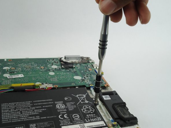

  3. Acer Chromebook CB3-131-C3KD Speakers Replacement: crwdns2935265:03crwdnd2935265:01crwdnd2935265:02crwdne2935265:0 Acer Chromebook CB3-131-C3KD Speakers Replacement: crwdns2935265:03crwdnd2935265:02crwdnd2935265:02crwdne2935265:0
    • Unscrew the (2) two 3mm J0 Phillips head screws that hold the battery in place.

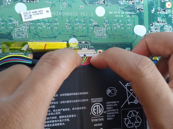

  4. Acer Chromebook CB3-131-C3KD Speakers Replacement: crwdns2935265:04crwdnd2935265:01crwdnd2935265:02crwdne2935265:0 Acer Chromebook CB3-131-C3KD Speakers Replacement: crwdns2935265:04crwdnd2935265:02crwdnd2935265:02crwdne2935265:0
    • Disconnect the battery from the motherboard.
    • Carefully disconnect the cable parallel to the board, not at an angle. Otherwise, you could damage the port.

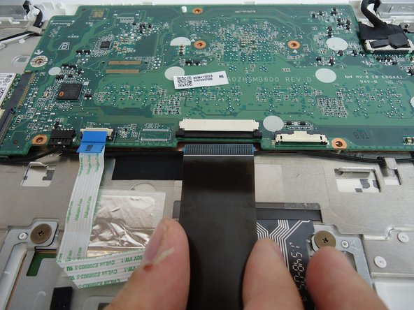

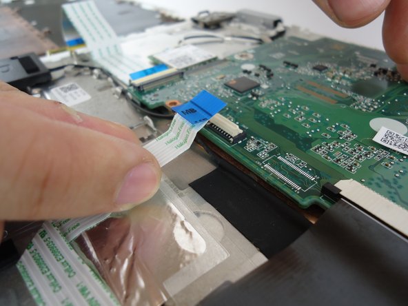

  6. Acer Chromebook CB3-131-C3KD Speakers Replacement, Speakers: crwdns2935265:06crwdnd2935265:01crwdnd2935265:03crwdne2935265:0 Acer Chromebook CB3-131-C3KD Speakers Replacement, Speakers: crwdns2935265:06crwdnd2935265:02crwdnd2935265:03crwdne2935265:0 Acer Chromebook CB3-131-C3KD Speakers Replacement, Speakers: crwdns2935265:06crwdnd2935265:03crwdnd2935265:03crwdne2935265:0
    • Disconnect the three ribbon cables from the motherboard.
  7. Acer Chromebook CB3-131-C3KD Speakers Replacement: crwdns2935265:07crwdnd2935265:01crwdnd2935265:02crwdne2935265:0 Acer Chromebook CB3-131-C3KD Speakers Replacement: crwdns2935265:07crwdnd2935265:02crwdnd2935265:02crwdne2935265:0
    • Unplug the cable by putting both thumbs on each tab and unlocking the cable by pushing the tabs away.

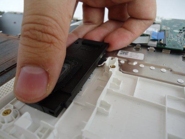

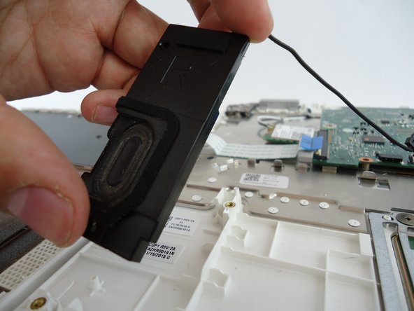

  8. Acer Chromebook CB3-131-C3KD Speakers Replacement: crwdns2935265:08crwdnd2935265:01crwdnd2935265:03crwdne2935265:0 Acer Chromebook CB3-131-C3KD Speakers Replacement: crwdns2935265:08crwdnd2935265:02crwdnd2935265:03crwdne2935265:0 Acer Chromebook CB3-131-C3KD Speakers Replacement: crwdns2935265:08crwdnd2935265:03crwdnd2935265:03crwdne2935265:0
    • Remove speakers by placing index finger on top and thumb on bottom of the speakers.
    • Peel speakers away from the base that is connected by an adhesive.

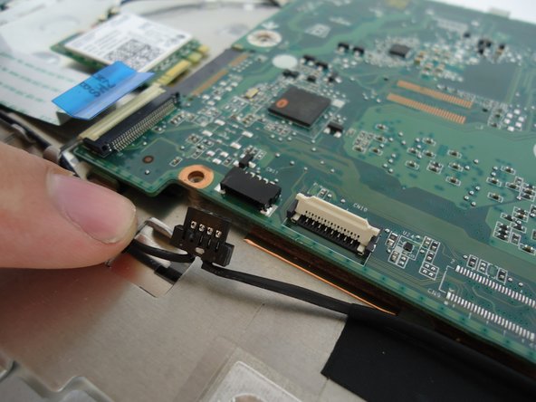

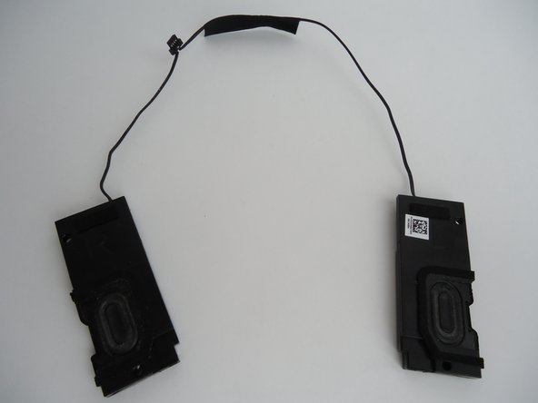

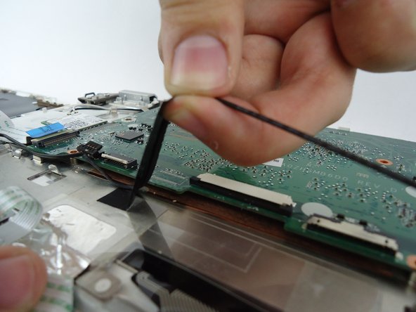

  9. Acer Chromebook CB3-131-C3KD Speakers Replacement: crwdns2935265:09crwdnd2935265:01crwdnd2935265:03crwdne2935265:0 Acer Chromebook CB3-131-C3KD Speakers Replacement: crwdns2935265:09crwdnd2935265:02crwdnd2935265:03crwdne2935265:0 Acer Chromebook CB3-131-C3KD Speakers Replacement: crwdns2935265:09crwdnd2935265:03crwdnd2935265:03crwdne2935265:0
    • Peel the black cord connecting the two speakers together away from the Velcro located at the midpoint between the two speakers.
    • Remove speakers from laptop.
