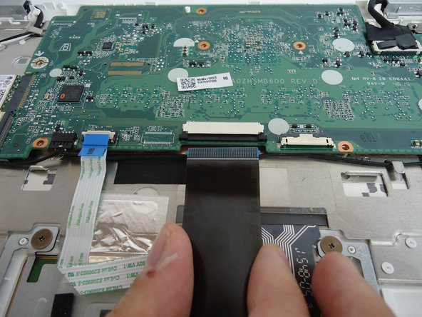

  6. Acer Chromebook CB3-131-C3KD Motherboard Replacement, Motherboard: crwdns2935265:06crwdnd2935265:01crwdnd2935265:02crwdne2935265:0 Acer Chromebook CB3-131-C3KD Motherboard Replacement, Motherboard: crwdns2935265:06crwdnd2935265:02crwdnd2935265:02crwdne2935265:0
    • Unscrew the (4) four J0 head 3.0 mm screws from the motherboard.
    • Unscrew the (1) one 7.0 mm screw from the center of the motherboard.

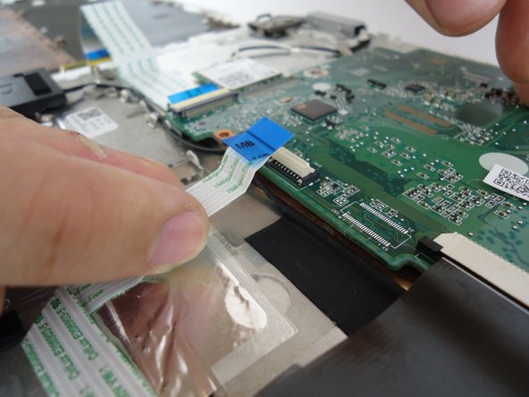

  7. Acer Chromebook CB3-131-C3KD Motherboard Replacement: crwdns2935265:07crwdnd2935265:01crwdnd2935265:03crwdne2935265:0 Acer Chromebook CB3-131-C3KD Motherboard Replacement: crwdns2935265:07crwdnd2935265:02crwdnd2935265:03crwdne2935265:0 Acer Chromebook CB3-131-C3KD Motherboard Replacement: crwdns2935265:07crwdnd2935265:03crwdnd2935265:03crwdne2935265:0
    • Unlock the latches on the three white ribbon cables, then pull to detach them from the motherboard.
    • Slide the hook forward and pull the black ribbon cable out.

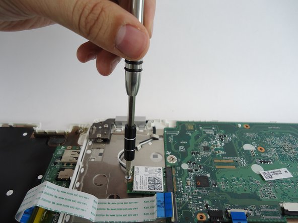

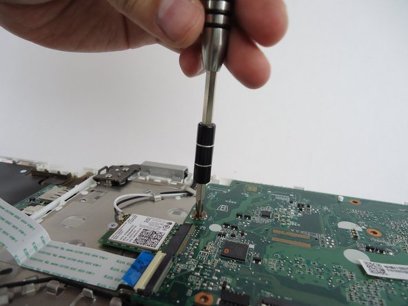

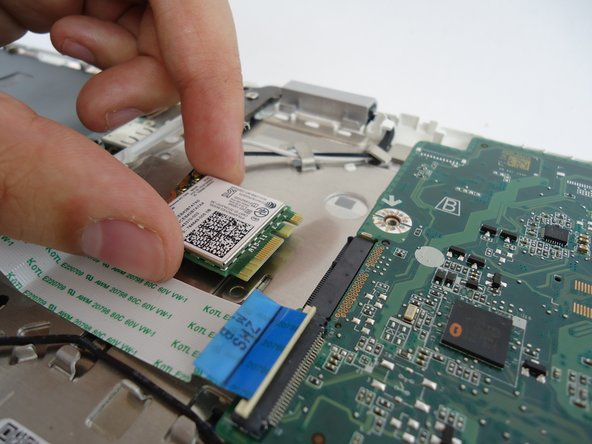

  8. Acer Chromebook CB3-131-C3KD Motherboard Replacement: crwdns2935265:08crwdnd2935265:01crwdnd2935265:03crwdne2935265:0 Acer Chromebook CB3-131-C3KD Motherboard Replacement: crwdns2935265:08crwdnd2935265:02crwdnd2935265:03crwdne2935265:0 Acer Chromebook CB3-131-C3KD Motherboard Replacement: crwdns2935265:08crwdnd2935265:03crwdnd2935265:03crwdne2935265:0
    • Unscrew the 4.0 mm screw from the Wi-fi card using the JIS #0 screwdriver.
    • Pull the Wi-fi card parallel to the Chromebook to remove.

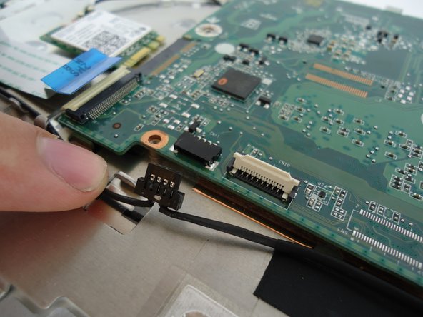

  9. Acer Chromebook CB3-131-C3KD Motherboard Replacement: crwdns2935265:09crwdnd2935265:01crwdnd2935265:03crwdne2935265:0 Acer Chromebook CB3-131-C3KD Motherboard Replacement: crwdns2935265:09crwdnd2935265:02crwdnd2935265:03crwdne2935265:0 Acer Chromebook CB3-131-C3KD Motherboard Replacement: crwdns2935265:09crwdnd2935265:03crwdnd2935265:03crwdne2935265:0
    • To remove the regular cable near the hinge, pry from one side.
    • To remove the regular cable at the top of the motherboard, pull it parallel to the board.

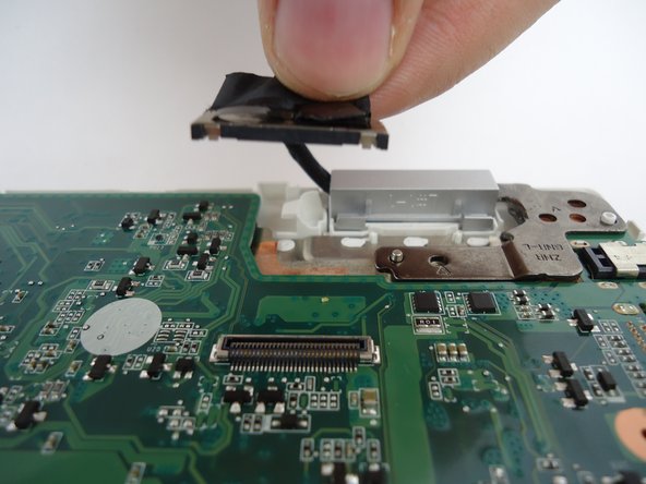

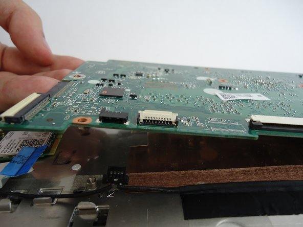

  10. Acer Chromebook CB3-131-C3KD Motherboard Replacement: crwdns2935265:010crwdnd2935265:01crwdnd2935265:02crwdne2935265:0 Acer Chromebook CB3-131-C3KD Motherboard Replacement: crwdns2935265:010crwdnd2935265:02crwdnd2935265:02crwdne2935265:0
    • Open the hinge by prying it backwards.
    • Be careful not to damage the ribbon cable connecting the back cover to the laptop.
    • Remove the motherboard by lifting from the top.
