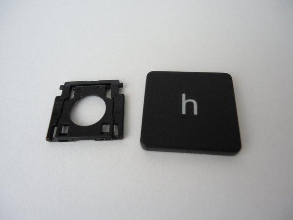

    • Make sure you turn off the laptop before starting.
    • Place the flat head screw driver under the key, but over the key clip retainer.
  2. Acer Chromebook CB3-131-C3KD Keyboard Key Replacement: crwdns2935265:02crwdnd2935265:01crwdnd2935265:01crwdne2935265:0
    • Push down on one of the bottom corners of the key, so that the opposite diagonal corner rises and gives leeway.
    • Carefully place the flat head screw driver under the raised corner.
    • Carefully pry up from underneath the raised corner to raise the metal clips away from the key base.
  3. Acer Chromebook CB3-131-C3KD Keyboard Key Replacement: crwdns2935265:03crwdnd2935265:01crwdnd2935265:02crwdne2935265:0 Acer Chromebook CB3-131-C3KD Keyboard Key Replacement: crwdns2935265:03crwdnd2935265:02crwdnd2935265:02crwdne2935265:0
    • Pry up from the top left and right corners of the retainer subsequently.
    • Remove clip retainer.
