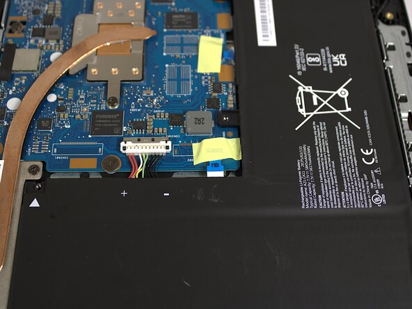

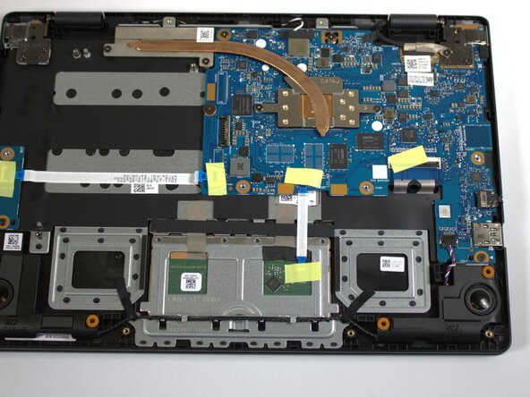

  3. Acer Chromebook CB0311-1H-C1MX Battery Replacement, Battery: crwdns2935265:03crwdnd2935265:01crwdnd2935265:01crwdne2935265:0
    • Using a JIS #1 screwdriver, remove all four 4.8 mm screws holding the battery in place.

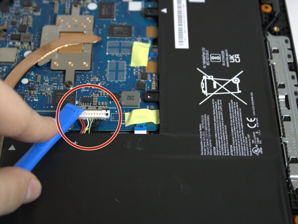

  4. Acer Chromebook CB0311-1H-C1MX Battery Replacement: crwdns2935265:04crwdnd2935265:01crwdnd2935265:02crwdne2935265:0 Acer Chromebook CB0311-1H-C1MX Battery Replacement: crwdns2935265:04crwdnd2935265:02crwdnd2935265:02crwdne2935265:0
    • Gently push on either side of the silver connector so that it no longer covers the battery cable.
    • Disconnect the battery cable by pulling it straight out.
    • This component is called the Flat Topped Connector.
  5. Acer Chromebook CB0311-1H-C1MX Battery Replacement: crwdns2935265:05crwdnd2935265:01crwdnd2935265:02crwdne2935265:0 Acer Chromebook CB0311-1H-C1MX Battery Replacement: crwdns2935265:05crwdnd2935265:02crwdnd2935265:02crwdne2935265:0
    • Lift and remove the battery from the laptop.
