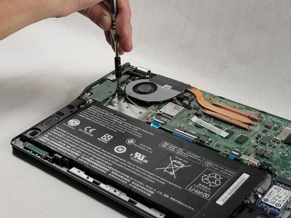

    • Remove the four 5mm screws on the heatsink using the Phillips #0 screwdriver.
  3. Acer Chromebook C740-C4PE Motherboard Replacement: crwdns2935265:03crwdnd2935265:01crwdnd2935265:02crwdne2935265:0 Acer Chromebook C740-C4PE Motherboard Replacement: crwdns2935265:03crwdnd2935265:02crwdnd2935265:02crwdne2935265:0
    • Loosen the two Phillips-head screws on the fan attached to the heatsink.

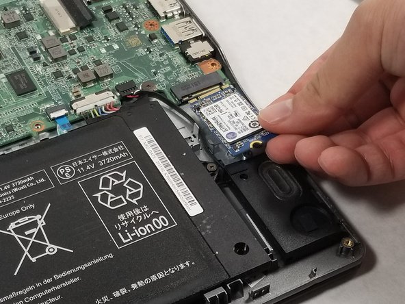

    • Remove the 5mm screw holding the SSD in place using the Phillips #0 screwdriver.
  9. Acer Chromebook C740-C4PE Motherboard Replacement: crwdns2935265:09crwdnd2935265:01crwdnd2935265:02crwdne2935265:0 Acer Chromebook C740-C4PE Motherboard Replacement: crwdns2935265:09crwdnd2935265:02crwdnd2935265:02crwdne2935265:0
    • Slide the SSD out of its slot in the motherboard.

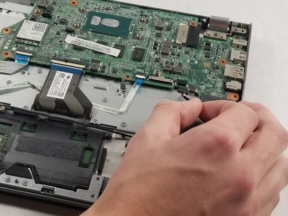

  14. Acer Chromebook C740-C4PE Motherboard Replacement: crwdns2935265:014crwdnd2935265:01crwdnd2935265:01crwdne2935265:0
    • Remove the touchpad cable from the zero insertion force connector on the motherboard.
    • Be sure to push up the plastic tab that holds the cable in place before removing it. Failure to do this could result in snapping the cable.
  15. Acer Chromebook C740-C4PE Motherboard Replacement: crwdns2935265:015crwdnd2935265:01crwdnd2935265:01crwdne2935265:0
    • Remove the keyboard cable from the zero insertion force connector on the motherboard.
    • Be sure to push open the plastic tab that holds the cable in place before removing the cable.
  16. Acer Chromebook C740-C4PE Motherboard Replacement: crwdns2935265:016crwdnd2935265:01crwdnd2935265:01crwdne2935265:0
    • Remove the mother-to-daughter cable from the zero insertion force connector on the motherboard.
