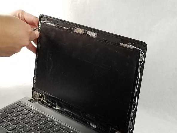

    • Remove the black frame off the screen by using a spudger.
    • It is recommended to start removing the frame from the top corner.

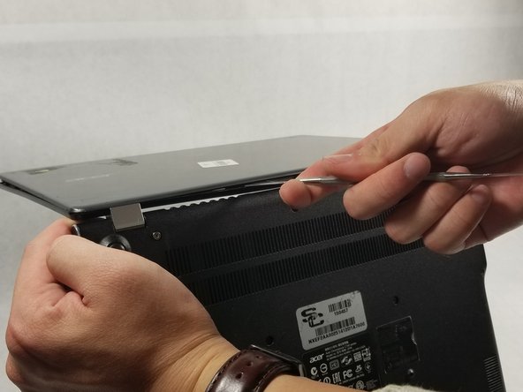

    • Use the spudger to open the two hinges that connect the screen frame to the bottom of the Chromebook.
    • Move the spudger along the bottom of the screen frame until you can pull the frame out entirely.

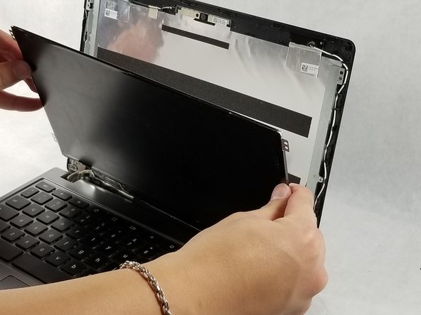

    • Place the LCD screen on top of the keyboard.

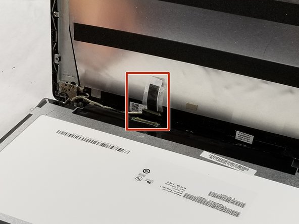

    • Lift the tape that holds the back of the LCD screen to the connector, and unplug the connector.
    • Remove the LCD screen and replace it with the new one.
