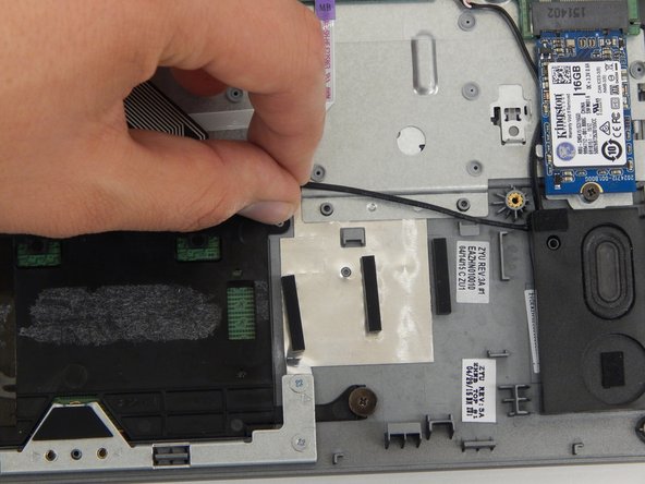

  7. Acer Chromebook C740 Trackpad Replacement, Trackpad: crwdns2935265:07crwdnd2935265:01crwdnd2935265:03crwdne2935265:0 Acer Chromebook C740 Trackpad Replacement, Trackpad: crwdns2935265:07crwdnd2935265:02crwdnd2935265:03crwdne2935265:0 Acer Chromebook C740 Trackpad Replacement, Trackpad: crwdns2935265:07crwdnd2935265:03crwdnd2935265:03crwdne2935265:0
    • Pull the black wire out from under the the black center clips and up from the gray outer clips with a spudger.

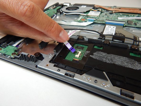

  8. Acer Chromebook C740 Trackpad Replacement: crwdns2935265:08crwdnd2935265:01crwdnd2935265:02crwdne2935265:0 Acer Chromebook C740 Trackpad Replacement: crwdns2935265:08crwdnd2935265:02crwdnd2935265:02crwdne2935265:0
    • Use a spudger to lift the black clip on the small purple ribbon cable connector to the left of the touchpad.
    • Pull the ribbon cable out from the connector.

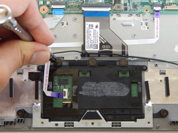

  9. Acer Chromebook C740 Trackpad Replacement: crwdns2935265:09crwdnd2935265:01crwdnd2935265:02crwdne2935265:0 Acer Chromebook C740 Trackpad Replacement: crwdns2935265:09crwdnd2935265:02crwdnd2935265:02crwdne2935265:0
    • Remove the five 2.5 mm screws with a Phillips #0 screwdriver.

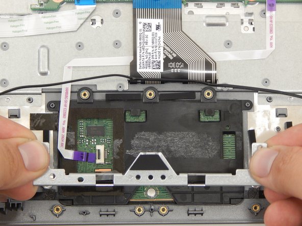

  11. Acer Chromebook C740 Trackpad Replacement: crwdns2935265:011crwdnd2935265:01crwdnd2935265:02crwdne2935265:0 Acer Chromebook C740 Trackpad Replacement: crwdns2935265:011crwdnd2935265:02crwdnd2935265:02crwdne2935265:0
    • Wiggle off the silver bracket with your fingers.

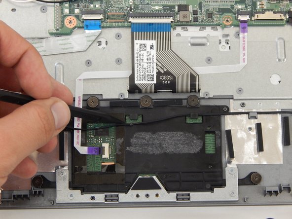

  12. Acer Chromebook C740 Trackpad Replacement: crwdns2935265:012crwdnd2935265:01crwdnd2935265:02crwdne2935265:0 Acer Chromebook C740 Trackpad Replacement: crwdns2935265:012crwdnd2935265:02crwdnd2935265:02crwdne2935265:0
    • Remove the black tape on the left side of the touchpad.

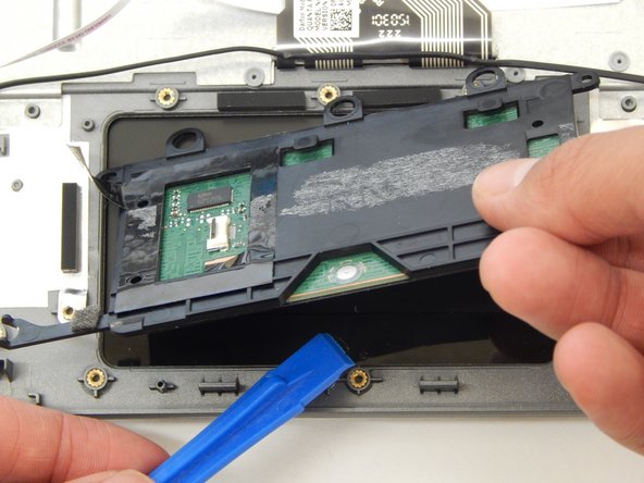

  13. Acer Chromebook C740 Trackpad Replacement: crwdns2935265:013crwdnd2935265:01crwdnd2935265:02crwdne2935265:0 Acer Chromebook C740 Trackpad Replacement: crwdns2935265:013crwdnd2935265:02crwdnd2935265:02crwdne2935265:0
    • Lift off the black plastic cover with the plastic opening tool.
