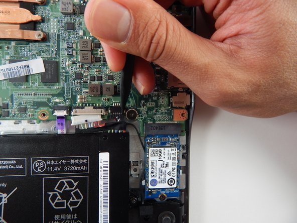

  8. Acer Chromebook C740 Motherboard Replacement: crwdns2935265:08crwdnd2935265:01crwdnd2935265:03crwdne2935265:0 Acer Chromebook C740 Motherboard Replacement: crwdns2935265:08crwdnd2935265:02crwdnd2935265:03crwdne2935265:0 Acer Chromebook C740 Motherboard Replacement: crwdns2935265:08crwdnd2935265:03crwdnd2935265:03crwdne2935265:0
    • Unplug the black connector attached to the motherboard at the top right of the battery by using a spudger to push the two L-shaped indentations towards the battery.

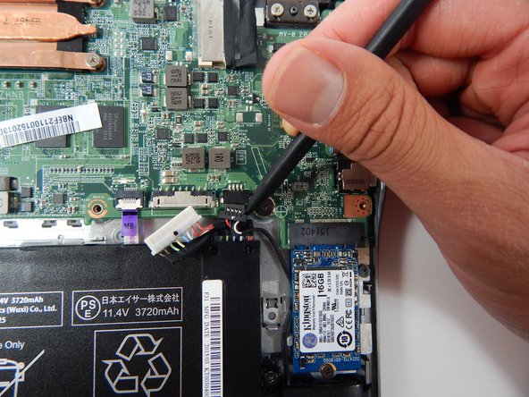

  9. Acer Chromebook C740 Motherboard Replacement: crwdns2935265:09crwdnd2935265:01crwdnd2935265:03crwdne2935265:0 Acer Chromebook C740 Motherboard Replacement: crwdns2935265:09crwdnd2935265:02crwdnd2935265:03crwdne2935265:0 Acer Chromebook C740 Motherboard Replacement: crwdns2935265:09crwdnd2935265:03crwdnd2935265:03crwdne2935265:0
    • Peel back the tape covering the white connector at the top-right of the motherboard.
    • Remove the connector from its fitting by pulling outwards.

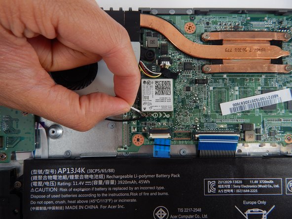

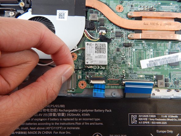

  11. Acer Chromebook C740 Motherboard Replacement: crwdns2935265:011crwdnd2935265:01crwdnd2935265:03crwdne2935265:0 Acer Chromebook C740 Motherboard Replacement: crwdns2935265:011crwdnd2935265:02crwdnd2935265:03crwdne2935265:0 Acer Chromebook C740 Motherboard Replacement: crwdns2935265:011crwdnd2935265:03crwdnd2935265:03crwdne2935265:0
    • Disconnect the two white and black wires by holding close to the metal snap-on caps and pulling upwards.

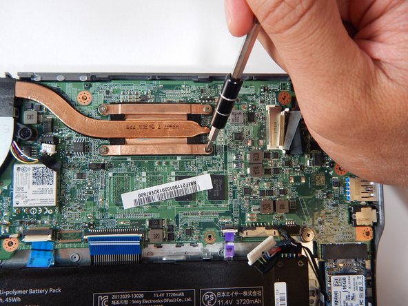

  13. Acer Chromebook C740 Motherboard Replacement: crwdns2935265:013crwdnd2935265:01crwdnd2935265:03crwdne2935265:0 Acer Chromebook C740 Motherboard Replacement: crwdns2935265:013crwdnd2935265:02crwdnd2935265:03crwdne2935265:0 Acer Chromebook C740 Motherboard Replacement: crwdns2935265:013crwdnd2935265:03crwdnd2935265:03crwdne2935265:0
    • Loosen the two black screws with a Phillips #0 screwdriver.
    • These screws cannot be removed. However, simply loosening them allows the heatsink fan to lift away from the motherboard.
    • Lift the heatsink fan and rotate it away from the mother board to set down outside the laptop.

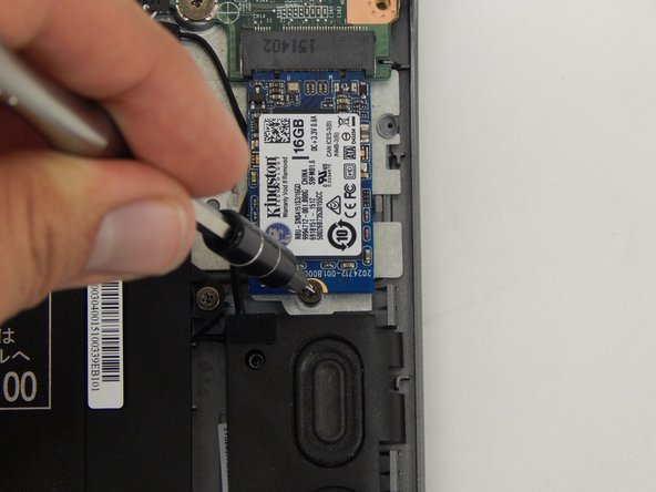

  15. Acer Chromebook C740 Motherboard Replacement: crwdns2935265:015crwdnd2935265:01crwdnd2935265:02crwdne2935265:0 Acer Chromebook C740 Motherboard Replacement: crwdns2935265:015crwdnd2935265:02crwdnd2935265:02crwdne2935265:0
    • Remove the 3.75 mm screw with a Phillips #0 screwdriver.
  16. Acer Chromebook C740 Motherboard Replacement: crwdns2935265:016crwdnd2935265:01crwdnd2935265:01crwdne2935265:0
    • Unplug the solid state drive.
