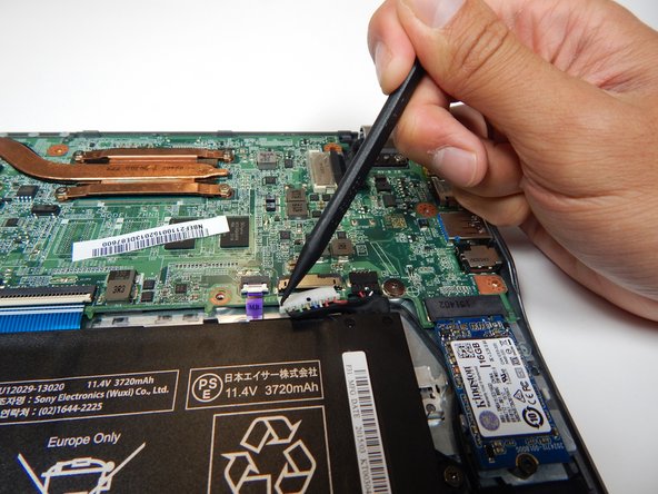

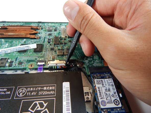

  4. Acer Chromebook C740 Battery Replacement, Battery: crwdns2935265:04crwdnd2935265:01crwdnd2935265:03crwdne2935265:0 Acer Chromebook C740 Battery Replacement, Battery: crwdns2935265:04crwdnd2935265:02crwdnd2935265:03crwdne2935265:0 Acer Chromebook C740 Battery Replacement, Battery: crwdns2935265:04crwdnd2935265:03crwdnd2935265:03crwdne2935265:0
    • Unplug the white 8-wire battery connector from the motherboard by using a spudger to push the two L-shaped indentations towards the battery.
    • The connector is a tight fit. This process requires going back-and-forth between the two indentations and plenty of patience.
