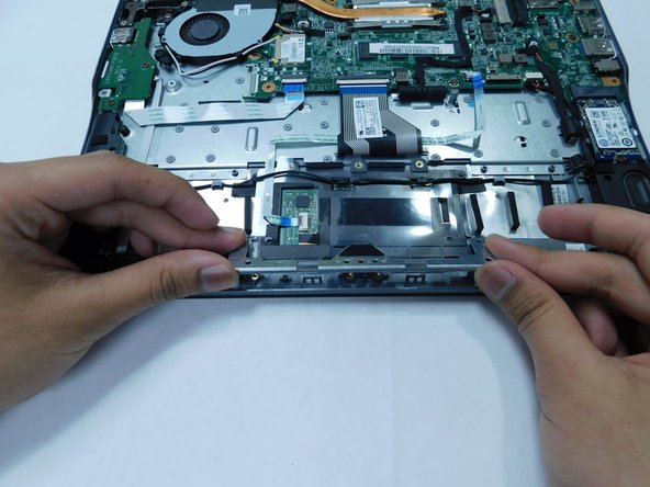

  7. Acer Chromebook C720-2844 Touch Pad Replacement: crwdns2935265:07crwdnd2935265:01crwdnd2935265:01crwdne2935265:0
    • Remove the tape securing the touchpad to the shell.
  8. Acer Chromebook C720-2844 Touch Pad Replacement: crwdns2935265:08crwdnd2935265:01crwdnd2935265:01crwdne2935265:0
    • Lift and remove touchpad.
