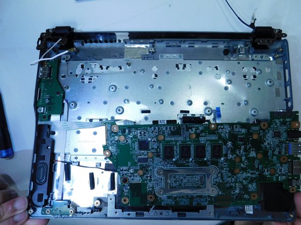

    • Unscrew and remove the 1 cm Phillips #00 screws from motherboard.
  2. Acer Chromebook C720-2844 Display Screen Replacement: crwdns2935265:02crwdnd2935265:01crwdnd2935265:02crwdne2935265:0 Acer Chromebook C720-2844 Display Screen Replacement: crwdns2935265:02crwdnd2935265:02crwdnd2935265:02crwdne2935265:0
    • Unscrew and remove the 1 cm Phillips #00 screw that secures the solid state drive.
    • Lift and pull towards you to remove.

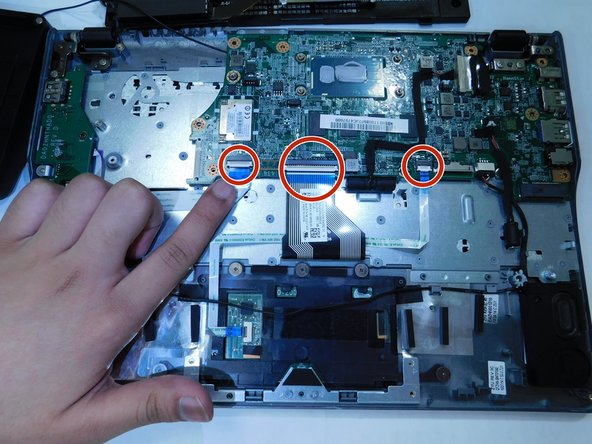

  3. Acer Chromebook C720-2844 Display Screen Replacement: crwdns2935265:03crwdnd2935265:01crwdnd2935265:01crwdne2935265:0
    • Disconnect the 3 cables shown by pulling back evenly from both ends.
  4. Acer Chromebook C720-2844 Display Screen Replacement: crwdns2935265:04crwdnd2935265:01crwdnd2935265:02crwdne2935265:0 Acer Chromebook C720-2844 Display Screen Replacement: crwdns2935265:04crwdnd2935265:02crwdnd2935265:02crwdne2935265:0
    • Unlock the cables shown by lifting the white tab on each.
    • Pull back on the blue tab to remove each cable from the motherboard.
  5. Acer Chromebook C720-2844 Display Screen Replacement: crwdns2935265:05crwdnd2935265:01crwdnd2935265:02crwdne2935265:0 Acer Chromebook C720-2844 Display Screen Replacement: crwdns2935265:05crwdnd2935265:02crwdnd2935265:02crwdne2935265:0
    • Remove the motherboard by shifting to the left and lifting up.
    • Unhook the black and white cables from underneath the motherboard.
