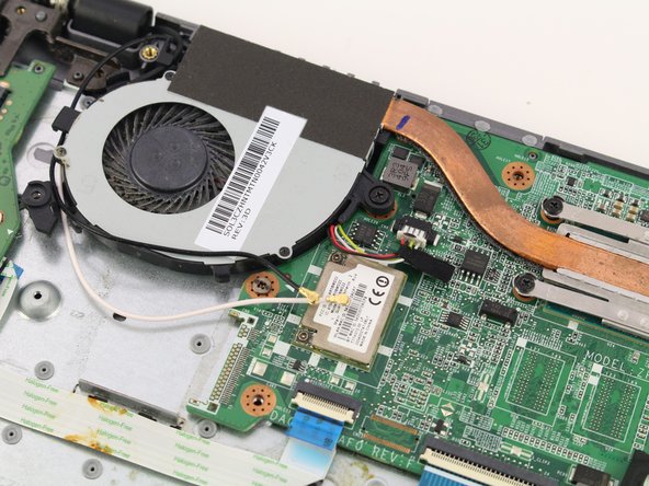

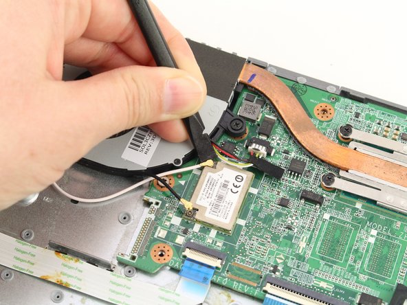

  8. Acer Chromebook C720-2827 Display Replacement: crwdns2935265:08crwdnd2935265:01crwdnd2935265:03crwdne2935265:0 Acer Chromebook C720-2827 Display Replacement: crwdns2935265:08crwdnd2935265:02crwdnd2935265:03crwdne2935265:0 Acer Chromebook C720-2827 Display Replacement: crwdns2935265:08crwdnd2935265:03crwdnd2935265:03crwdne2935265:0
    • Use the spudger to gently disconnect the black and white coaxial antenna cables off of the WLAN card.

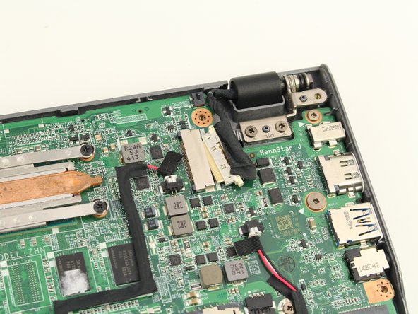

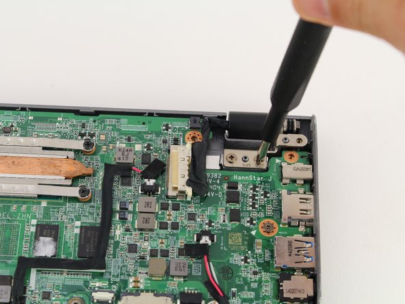

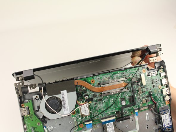

  9. Acer Chromebook C720-2827 Display Replacement: crwdns2935265:09crwdnd2935265:01crwdnd2935265:03crwdne2935265:0 Acer Chromebook C720-2827 Display Replacement: crwdns2935265:09crwdnd2935265:02crwdnd2935265:03crwdne2935265:0 Acer Chromebook C720-2827 Display Replacement: crwdns2935265:09crwdnd2935265:03crwdnd2935265:03crwdne2935265:0
    • Using your Phillips #1 screwdriver, unscrew two 3.7mm screws from the right display hinge.
    • Using your Phillips #1 screwdriver, unscrew two 5.7mm screws from the left display hinge.
    • When removing the display, be careful to unthread the black coaxial antenna cable underneath the motherboard from the opposite side of the panel.
