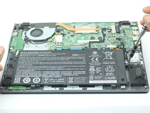

    • Place your Chromebook upside down.
    • Utilizing the precision magnetized Phillips #0 screwdriver, remove all thirteen 6.5 mm Phillips screws that secure the back cover.
    • Before doing anything, make sure your Acer Chromebook is completely turned off.

  3. Acer Chromebook C720-2420 Motherboard Replacement, Battery: crwdns2935265:03crwdnd2935265:01crwdnd2935265:02crwdne2935265:0 Acer Chromebook C720-2420 Motherboard Replacement, Battery: crwdns2935265:03crwdnd2935265:02crwdnd2935265:02crwdne2935265:0
    • Remove the two 3.6 mm Phillips screws holding the battery in place.

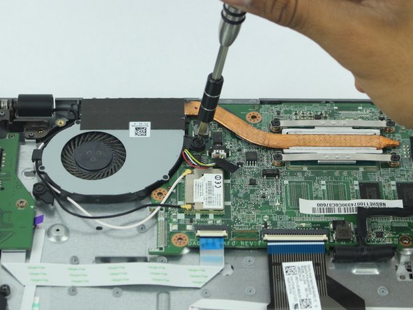

  6. Acer Chromebook C720-2420 Motherboard Replacement, cooling fan / CPU heat sink assembly: crwdns2935265:06crwdnd2935265:01crwdnd2935265:02crwdne2935265:0 Acer Chromebook C720-2420 Motherboard Replacement, cooling fan / CPU heat sink assembly: crwdns2935265:06crwdnd2935265:02crwdnd2935265:02crwdne2935265:0
    • Remove the six 4.7 mm Phillips screws that secure the fan.

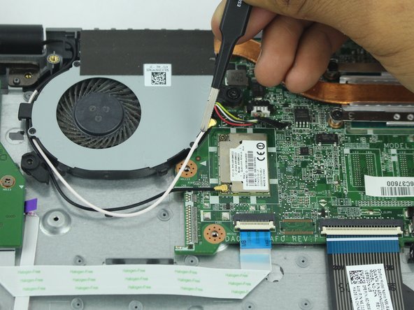

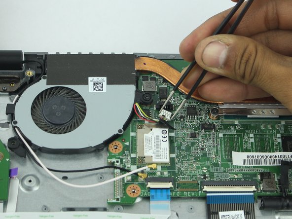

  7. Acer Chromebook C720-2420 Motherboard Replacement: crwdns2935265:07crwdnd2935265:01crwdnd2935265:03crwdne2935265:0 Acer Chromebook C720-2420 Motherboard Replacement: crwdns2935265:07crwdnd2935265:02crwdnd2935265:03crwdne2935265:0 Acer Chromebook C720-2420 Motherboard Replacement: crwdns2935265:07crwdnd2935265:03crwdnd2935265:03crwdne2935265:0
    • Disconnect these cables from the motherboard using the tweezers.
    • Alternatively, you may use your hands.
    • Pull out the fan.

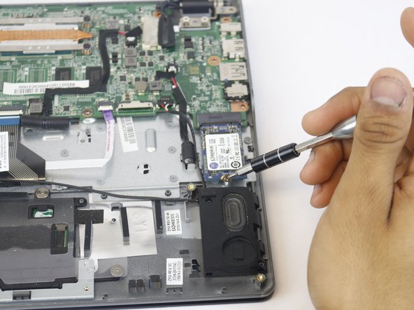

  8. Acer Chromebook C720-2420 Motherboard Replacement, Memory: crwdns2935265:08crwdnd2935265:01crwdnd2935265:02crwdne2935265:0 Acer Chromebook C720-2420 Motherboard Replacement, Memory: crwdns2935265:08crwdnd2935265:02crwdnd2935265:02crwdne2935265:0
    • Remove the 3.6 mm Phillips screw that secures the SSD in place.
  9. Acer Chromebook C720-2420 Motherboard Replacement: crwdns2935265:09crwdnd2935265:01crwdnd2935265:02crwdne2935265:0 Acer Chromebook C720-2420 Motherboard Replacement: crwdns2935265:09crwdnd2935265:02crwdnd2935265:02crwdne2935265:0
    • Pull out the SSD.
