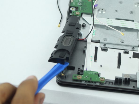

    • Remove the speakers located on both left and right bottom corners of the Chromebook with a plastic opening tool.

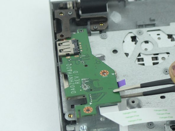

    • Remove the two 3.6 mm Phillips screws holding the USB and SD card port with a PH0 screwdriver.
    • Lift out and remove the port.

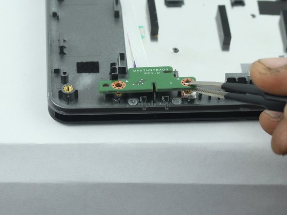

    • Remove the two 3.6 mm Phillips screws holding the LED sensors.
    • Remove the LED Sensors.

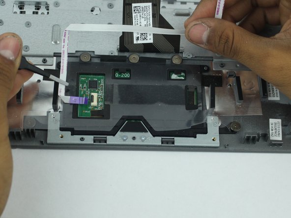

  21. Acer Chromebook C720-2420 Keyboard Replacement: crwdns2935265:021crwdnd2935265:01crwdnd2935265:02crwdne2935265:0 Acer Chromebook C720-2420 Keyboard Replacement: crwdns2935265:021crwdnd2935265:02crwdnd2935265:02crwdne2935265:0
    • Flip up the black tab on the ZIF connector to release the ribbon cable.
    • Remove the ribbon cable.
    • This ribbon is fragile, do not use excessive force.

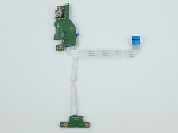

  22. Acer Chromebook C720-2420 Keyboard Replacement: crwdns2935265:022crwdnd2935265:01crwdnd2935265:01crwdne2935265:0
    • Leave only the single ribbon cable.
