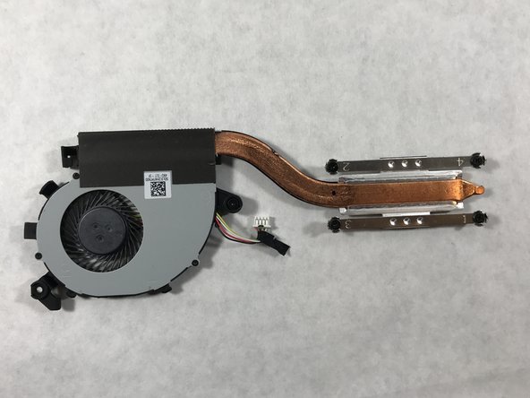

  6. Acer Chromebook C720-2103 Motherboard Replacement, Fan: crwdns2935265:06crwdnd2935265:01crwdnd2935265:02crwdne2935265:0 Acer Chromebook C720-2103 Motherboard Replacement, Fan: crwdns2935265:06crwdnd2935265:02crwdnd2935265:02crwdne2935265:0
    • Remove all four 6mm screws attaching the fan to the motherboard with a Phillips #0 screwdriver.
    • Remove the two 6mm screws attaching the fan to the device base with the Phillips #0 screwdriver.
    • These screws are permanently set into the fan. Once unscrewed from the base, the two screws will still be attached to the fan.

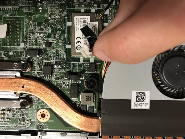

  8. Acer Chromebook C720-2103 Motherboard Replacement: crwdns2935265:08crwdnd2935265:01crwdnd2935265:02crwdne2935265:0 Acer Chromebook C720-2103 Motherboard Replacement: crwdns2935265:08crwdnd2935265:02crwdnd2935265:02crwdne2935265:0
    • Peel up the tape attaching the rainbow connector wire to the motherboard, but leave the tape attached to the wire itself.
    • Removing the tape from the wire can damage the wire.
    • Pull the rainbow cable connector out of the black terminal by wiggling it gently from side to side with your fingers.

    • Lift the fan component up and out of device with your hands. Take care not to knock the fan against the motherboard.

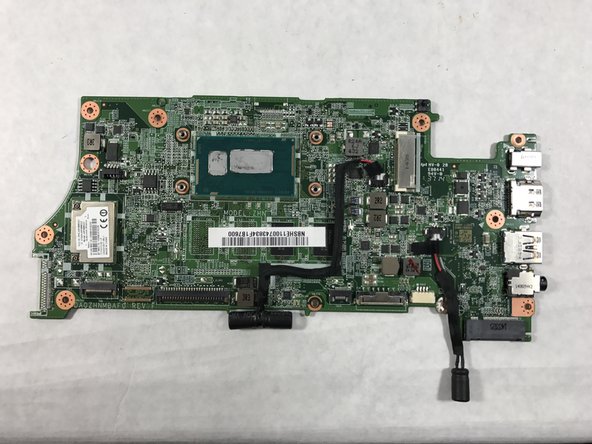

  12. Acer Chromebook C720-2103 Motherboard Replacement, Motherboard: crwdns2935265:012crwdnd2935265:01crwdnd2935265:01crwdne2935265:0
    • Unscrew the five screws attaching the motherboard to the device base.
    • Be careful, the mother board is very fragile.
  13. Acer Chromebook C720-2103 Motherboard Replacement: crwdns2935265:013crwdnd2935265:01crwdnd2935265:01crwdne2935265:0
    • Push the three white hinges upward, gently, with your finger or a spudger. The hinges will move away from the blue tab on the cables. This will release the ribbon cables sandwiched under the hinge.
    • The white hinges are also attached to a black base on one side. Do not try to pry the black bases off the motherboard. This will break them.
    • Pull the ribbon cables away from their black bases gently with your fingers. Hold the whole cable by the end with the blue tab, but do not pull on the blue tab alone. That can rip the tab off.
  14. Acer Chromebook C720-2103 Motherboard Replacement: crwdns2935265:014crwdnd2935265:01crwdnd2935265:01crwdne2935265:0
    • Detach the tape from the motherboard, but leave it attached to the wire itself to avoid damaging the wire.
    • Pull the white cable connector out of the black terminal by wiggling it gently from side to side with your fingers.
    • Pull the black cable connector out of the white terminal by wiggling it gently from side to side with your fingers.
    • Be sure not to pull on the cables too hard as they are fragile .
  15. Acer Chromebook C720-2103 Motherboard Replacement: crwdns2935265:015crwdnd2935265:01crwdnd2935265:02crwdne2935265:0 Acer Chromebook C720-2103 Motherboard Replacement: crwdns2935265:015crwdnd2935265:02crwdnd2935265:02crwdne2935265:0
    • Remove the motherboard from the device base.
