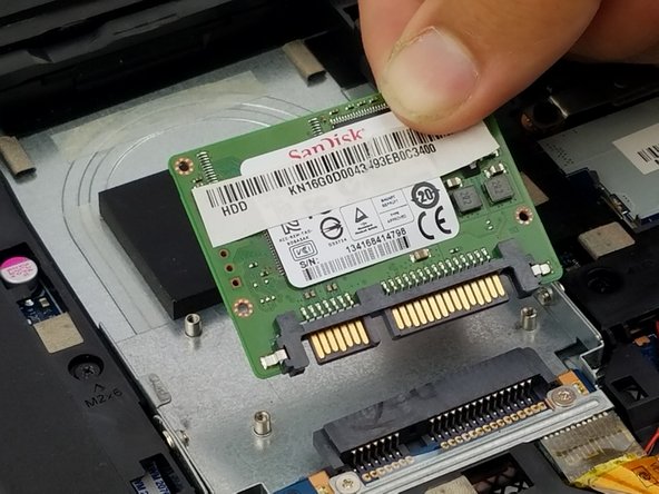

  2. Acer Chromebook C710-2856 Hard Drive Replacement, Unscrewing the Drive: crwdns2935265:02crwdnd2935265:01crwdnd2935265:01crwdne2935265:0
    • Remove the four 2.8mm Phillips #000 screws holding the drive onto the case.
  3. Acer Chromebook C710-2856 Hard Drive Replacement, Uncovering the Pins: crwdns2935265:03crwdnd2935265:01crwdnd2935265:01crwdne2935265:0
    • Gently pull the foam protector away from the pin connectors
  4. Acer Chromebook C710-2856 Hard Drive Replacement, Disconnecting the Drive: crwdns2935265:04crwdnd2935265:01crwdnd2935265:02crwdne2935265:0 Acer Chromebook C710-2856 Hard Drive Replacement, Disconnecting the Drive: crwdns2935265:04crwdnd2935265:02crwdnd2935265:02crwdne2935265:0
    • Gently pull the drive up and away to disconnect the hard drive from its seat
  5. Acer Chromebook C710-2856 Hard Drive Replacement, Removed Drive and Pieces: crwdns2935265:05crwdnd2935265:01crwdnd2935265:01crwdne2935265:0
    • Fully removed hard drive, screws, and foam cover
