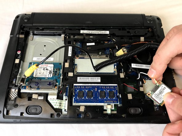

  4. Acer Chromebook C710-2833 Wifi Card Replacement: crwdns2935265:04crwdnd2935265:01crwdnd2935265:01crwdne2935265:0
    • Locate the 3 mm Phillips #00 screw on the wireless card port.
    • Unscrew the screw and place it aside for now.

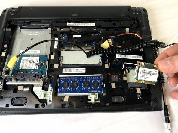

  5. Acer Chromebook C710-2833 Wifi Card Replacement: crwdns2935265:05crwdnd2935265:01crwdnd2935265:03crwdne2935265:0 Acer Chromebook C710-2833 Wifi Card Replacement: crwdns2935265:05crwdnd2935265:02crwdnd2935265:03crwdne2935265:0 Acer Chromebook C710-2833 Wifi Card Replacement: crwdns2935265:05crwdnd2935265:03crwdnd2935265:03crwdne2935265:0
    • Safely remove the wireless card by pulling it out of the bottom of the port.
    • Lastly, disconnect the two white and black wire connectors attached to the wireless card.

Replaced the original wifi card, how do you get Chrome OS to recognize, or find and download driver for Intel AC 7260 wifi card?
Thanks.
