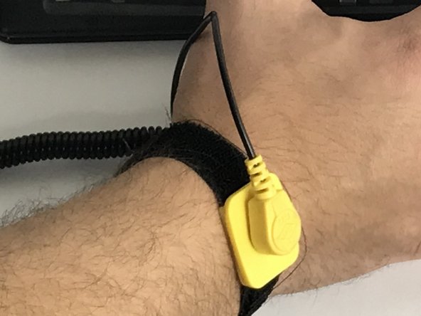

    • Now take your anti-static wrist strap and place it tightly on your wrist.
    • Attach the alligator clamp of the wrist strap to something that will ground yourself to avoid possible electric zaps.
    • The location chosen in the picture is recommended.
