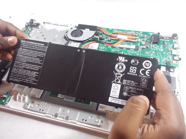

  7. Acer Chromebook 15 CB5-571-C09S Track Pad Replacement: crwdns2935265:07crwdnd2935265:01crwdnd2935265:02crwdne2935265:0 Acer Chromebook 15 CB5-571-C09S Track Pad Replacement: crwdns2935265:07crwdnd2935265:02crwdnd2935265:02crwdne2935265:0
    • Once the battery has been disconnected from the motherboard it can easily be removed from the device.
    • Grab the top edge of the battery and carefully pull it up and out of the device towards you.
