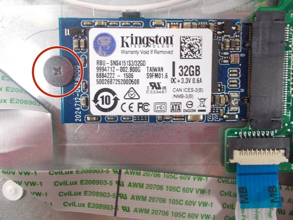

    • The Solid State Drive is the blue chip locate right beneath the fan.
    • Unscrew the 3 mm PH00 Phillips head screw located on the left side of the SSD.

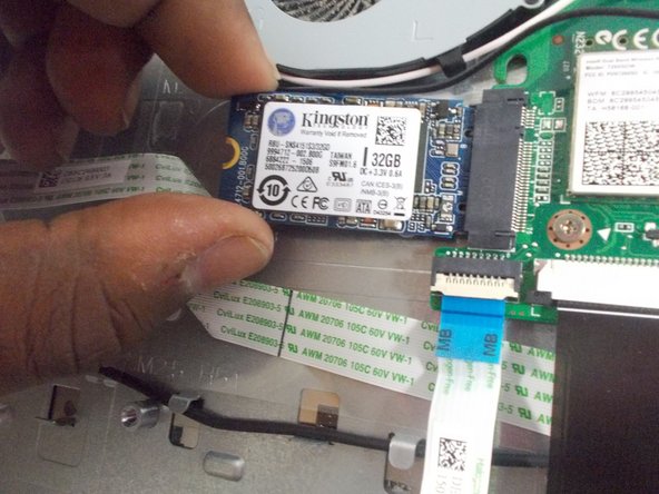

    • Grab the top and bottom edges of the SSD and carefully pull it out from the motherboard.

Mine has a positive and neutral wire moving away from the SSD, and removing the chip entirely hasn't impeded operation whatsoever despite me doing it to force developer mode.
