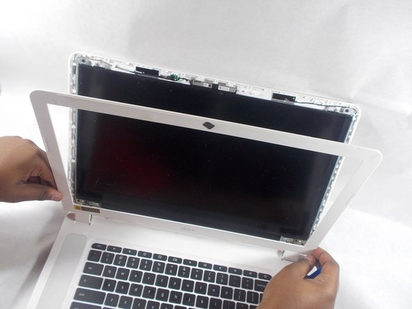

  3. Acer Chromebook 15 CB5-571-C09S Screen Replacement: crwdns2935265:03crwdnd2935265:01crwdnd2935265:02crwdne2935265:0 Acer Chromebook 15 CB5-571-C09S Screen Replacement: crwdns2935265:03crwdnd2935265:02crwdnd2935265:02crwdne2935265:0
    • Remove the screen cover from the screen.
    • Pry off a pair of small covers at the back of the hinges first.
    • Carefully grab the edges of the screen cover from opposite ends and pull off the screen towards you.

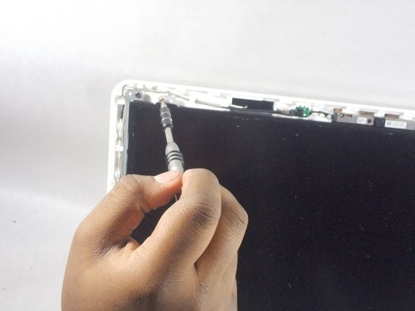

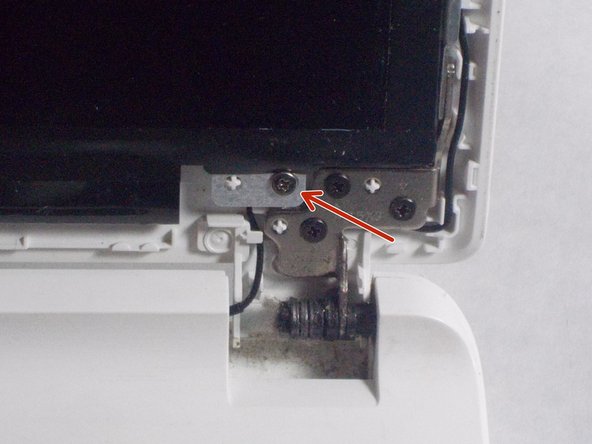

  4. Acer Chromebook 15 CB5-571-C09S Screen Replacement: crwdns2935265:04crwdnd2935265:01crwdnd2935265:03crwdne2935265:0 Acer Chromebook 15 CB5-571-C09S Screen Replacement: crwdns2935265:04crwdnd2935265:02crwdnd2935265:03crwdne2935265:0 Acer Chromebook 15 CB5-571-C09S Screen Replacement: crwdns2935265:04crwdnd2935265:03crwdnd2935265:03crwdne2935265:0
    • Unscrew the four 3 mm PH00 Phillips head screws located on the inside corners of the screen.
    • Be sure to unscrew the inner screws attached to the screen and not the outer screws.
