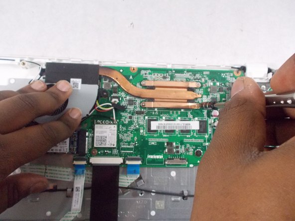

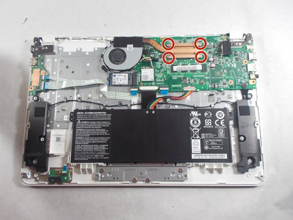

  5. Acer Chromebook 15 CB5-571-C09S Fan Replacement, Fan: crwdns2935265:05crwdnd2935265:01crwdnd2935265:03crwdne2935265:0 Acer Chromebook 15 CB5-571-C09S Fan Replacement, Fan: crwdns2935265:05crwdnd2935265:02crwdnd2935265:03crwdne2935265:0 Acer Chromebook 15 CB5-571-C09S Fan Replacement, Fan: crwdns2935265:05crwdnd2935265:03crwdnd2935265:03crwdne2935265:0
    • The fan is located at the top of the device enclosed by a grey plastic covering and is attached to the motherboard by a piece of brass colored metal.
    • Unscrew the four 3 mm PH00 Phillips screws located on the corner edges of the brass colored piece of metal.

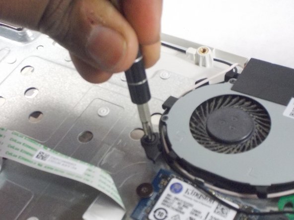

  6. Acer Chromebook 15 CB5-571-C09S Fan Replacement: crwdns2935265:06crwdnd2935265:01crwdnd2935265:02crwdne2935265:0 Acer Chromebook 15 CB5-571-C09S Fan Replacement: crwdns2935265:06crwdnd2935265:02crwdnd2935265:02crwdne2935265:0
    • Unscrew the two 4 mm PH00 Phillips head screws on either side of the the fan.
    • Be aware that these screw are enclosed by small pieces of plastic and are not to be removed from the fan cover.

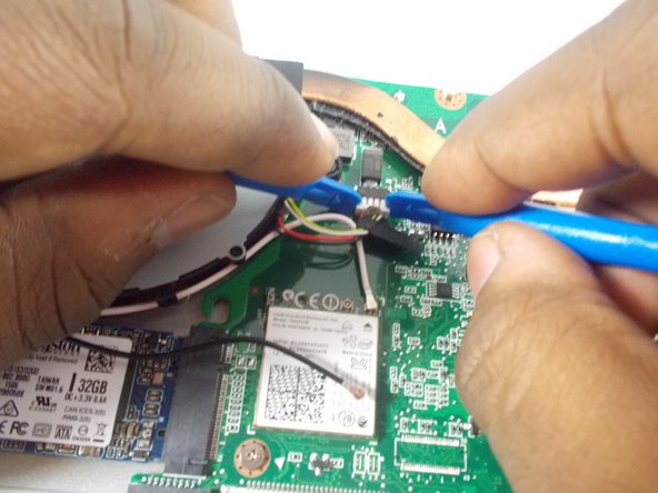

  7. Acer Chromebook 15 CB5-571-C09S Fan Replacement: crwdns2935265:07crwdnd2935265:01crwdnd2935265:02crwdne2935265:0 Acer Chromebook 15 CB5-571-C09S Fan Replacement: crwdns2935265:07crwdnd2935265:02crwdnd2935265:02crwdne2935265:0
    • Disconnect the fan connector from the motherboard using two plastic opening tools.
    • The fan connector is the white "plug" that connects the battery to the motherboard with yellow, white, red and black wires attached to it.
  8. Acer Chromebook 15 CB5-571-C09S Fan Replacement: crwdns2935265:08crwdnd2935265:01crwdnd2935265:02crwdne2935265:0 Acer Chromebook 15 CB5-571-C09S Fan Replacement: crwdns2935265:08crwdnd2935265:02crwdnd2935265:02crwdne2935265:0
    • Carefully unwrap the black and white wires from around the fan cover.
    • Be careful not to remove the wires from the Intel Dual Band Wireless-AC 7260 ports located just beneath the fan connector.

Thanks for the guide. I was able to successfully replace my fan using it. I would like to point out a couple of things:
1. 10 minutes is not a realistic completion time for this guide.
2. Disconnecting the fan plug is challenging. It might have been easier with a small pair of pliers.
3. Since this guide involves dis/re-connecting the thermal interface between the processor and heat sink, you should be prepared to properly clean both surfaces and re-apply new thermal compound. There is an excellent guide on applying thermal compound here:
