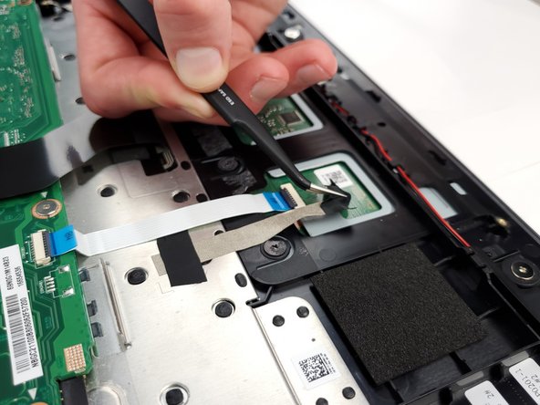

    • Use tweezers to set aside the electric tape (black) and the ground tape (tan) to reveal the trackpad screws and ribbon connector.
  6. Acer Chromebook 14 CB3-431-C7EX Trackpad Replacement: crwdns2935265:06crwdnd2935265:01crwdnd2935265:03crwdne2935265:0 Acer Chromebook 14 CB3-431-C7EX Trackpad Replacement: crwdns2935265:06crwdnd2935265:02crwdnd2935265:03crwdne2935265:0 Acer Chromebook 14 CB3-431-C7EX Trackpad Replacement: crwdns2935265:06crwdnd2935265:03crwdnd2935265:03crwdne2935265:0
    • Use a spudger to disconnect the connector that connects the trackpad to the motherboard. Once the locking tab of the ZIF connector is flipped up, the ribbon cable should slide out toward the motherboard.
    • Be sure to remove the connector evenly from the port, as the ribbon connector may be fragile.

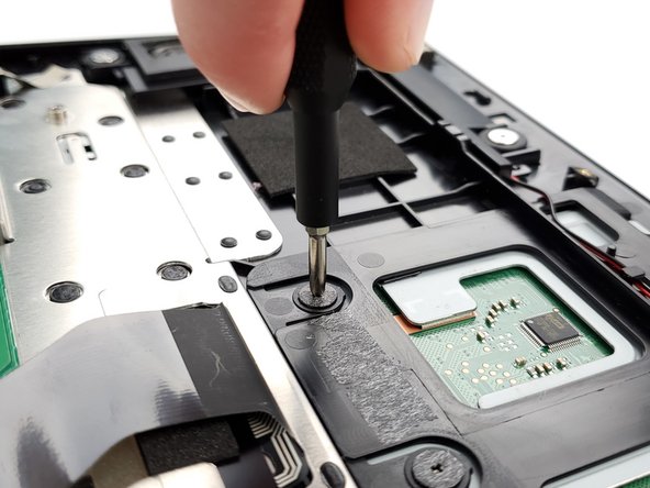

    • Use a Phillips #0 screwdriver to unscrew the three 2mm screws from the top of the trackpad.

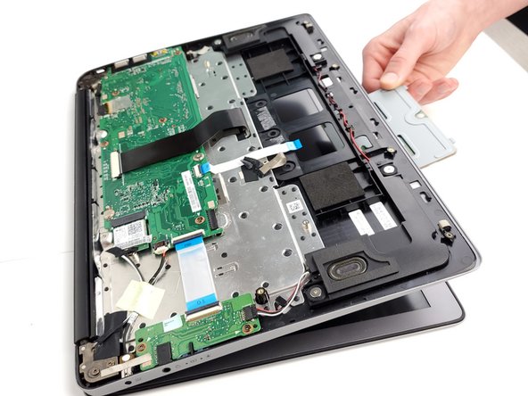

    • Remove the trackpad out from its housing by first sliding it towards the keyboard and then down towards the screen.
    • Be mindful of the two tabs that secure the bottom of the trackpad.
