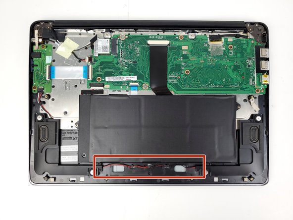

    • Use a Phillips #0 screwdriver to unscrew the eight 4mm screws.
    • Use a Phillips #0 screwdriver to unscrew the two 7mm screws and then remove the cover.
    • iFixit's magnetic project mat is great for keeping the screws organized.
    • Remove the cover of the device by prying up from one of the edges with a spudger or plastic opening tool.
    • If the back cover is hard to remove, carefully use a metal spudger to remove the back cover.

    • Use a spudger to disconnect the speaker connector from the bottom of the sound card. The connector should slide out toward the left speaker's housing.
    • Be sure to remove the connector evenly from the port.

    • Use a Phillips #0 screwdriver to unscrew the four 5.5mm screws from the battery housing.
  4. Acer Chromebook 14 CB3-431-C7EX Speakers Replacement: crwdns2935265:04crwdnd2935265:01crwdnd2935265:03crwdne2935265:0 Acer Chromebook 14 CB3-431-C7EX Speakers Replacement: crwdns2935265:04crwdnd2935265:02crwdnd2935265:03crwdne2935265:0 Acer Chromebook 14 CB3-431-C7EX Speakers Replacement: crwdns2935265:04crwdnd2935265:03crwdnd2935265:03crwdne2935265:0

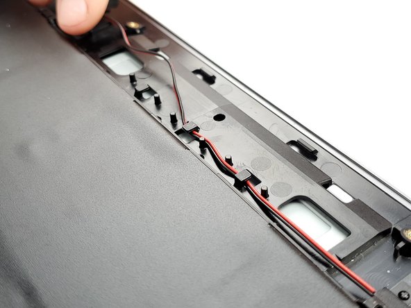

    • Lift the left and right speakers directly upward from the laptop to remove them.
    • Unwind the wire connecting the two speakers from the slalom.
    • The connection between the wire and the speakers may be fragile.
