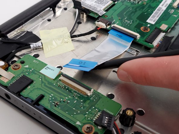

  3. Acer Chromebook 14 CB3-431-C7EX Headphone Jack Replacement: crwdns2935265:03crwdnd2935265:01crwdnd2935265:02crwdne2935265:0 Acer Chromebook 14 CB3-431-C7EX Headphone Jack Replacement: crwdns2935265:03crwdnd2935265:02crwdnd2935265:02crwdne2935265:0
    • Use a spudger to carefully disconnect the ribbon connector from the right side of the sound card. The connector should slide out toward the motherboard.
    • Be sure to remove the connector evenly from the port, as the ribbon connector may be fragile.

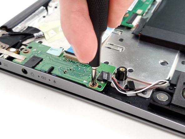

  4. Acer Chromebook 14 CB3-431-C7EX Headphone Jack Replacement: crwdns2935265:04crwdnd2935265:01crwdnd2935265:02crwdne2935265:0 Acer Chromebook 14 CB3-431-C7EX Headphone Jack Replacement: crwdns2935265:04crwdnd2935265:02crwdnd2935265:02crwdne2935265:0
    • Use a Phillips #0 screwdriver to unscrew the two 4mm screws.
  5. Acer Chromebook 14 CB3-431-C7EX Headphone Jack Replacement: crwdns2935265:05crwdnd2935265:01crwdnd2935265:01crwdne2935265:0
    • Slide the sound card towards the motherboard until the headphone jack is out of its hole on the side of the laptop.
    • Lift the sound card directly up from the laptop to remove it.
