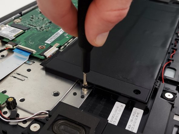

    • Use a Phillips #0 screwdriver to unscrew the two 5.5mm screws from the battery housing.
