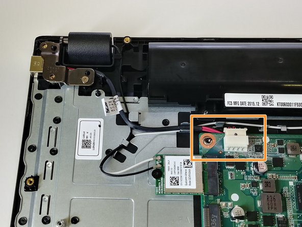

  5. Acer Aspire V5-591G-75KE Power Jack Harness Replacement, Power Jack Harness: crwdns2935265:05crwdnd2935265:01crwdnd2935265:02crwdne2935265:0 Acer Aspire V5-591G-75KE Power Jack Harness Replacement, Power Jack Harness: crwdns2935265:05crwdnd2935265:02crwdnd2935265:02crwdne2935265:0
    • Locate the power jack harness on the upper left quadrant of your device.
    • Note where the power jack harness connects to the mother board of your device.
  6. Acer Aspire V5-591G-75KE Power Jack Harness Replacement: crwdns2935265:06crwdnd2935265:01crwdnd2935265:01crwdne2935265:0
    • With a pair of blunt tweezers, push on the side tabs of the connector to disconnect the harness from the motherboard.

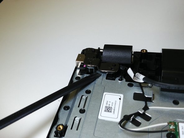

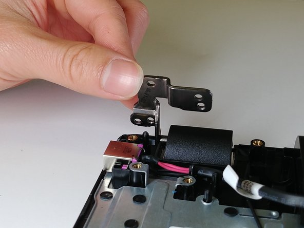

    • Using a Phillips #1 screwdriver, remove the single 10mm Phillips Head screw located on the hinge.
    • Wedge the spudger tool below the hinge, and lift only enough to get a grip with your fingers.
    • Use your hand to lift the hinge the rest of the way to avoid damaging your spudger tool.

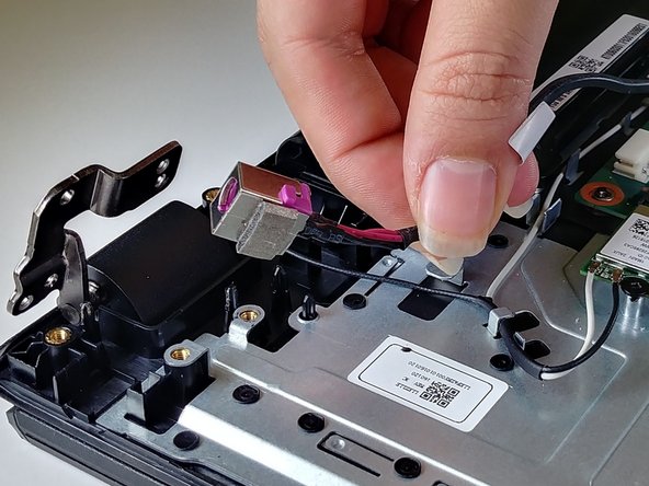

  8. Acer Aspire V5-591G-75KE Power Jack Harness Replacement: crwdns2935265:08crwdnd2935265:01crwdnd2935265:02crwdne2935265:0 Acer Aspire V5-591G-75KE Power Jack Harness Replacement: crwdns2935265:08crwdnd2935265:02crwdnd2935265:02crwdne2935265:0
    • Wedge the spudger tool below the port harness head, and lift straight up until the side tabs clear the channels on each side.
    • There is a piece of tape holding the power jack harness in place, which will give you some resistance. Prying through this tape will not damage the harness.
  9. Acer Aspire V5-591G-75KE Power Jack Harness Replacement: crwdns2935265:09crwdnd2935265:01crwdnd2935265:01crwdne2935265:0
    • Lift to completely remove the rest of the power jack harness out of the casing.
