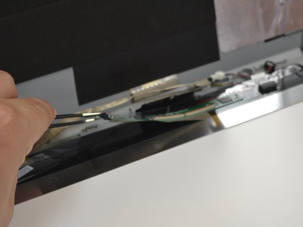

    • Use the blunt nose tweezers to peel up the adhesive on the display cable.
    • Pull on the adhesive tape to disconnect the display from the motherboard.

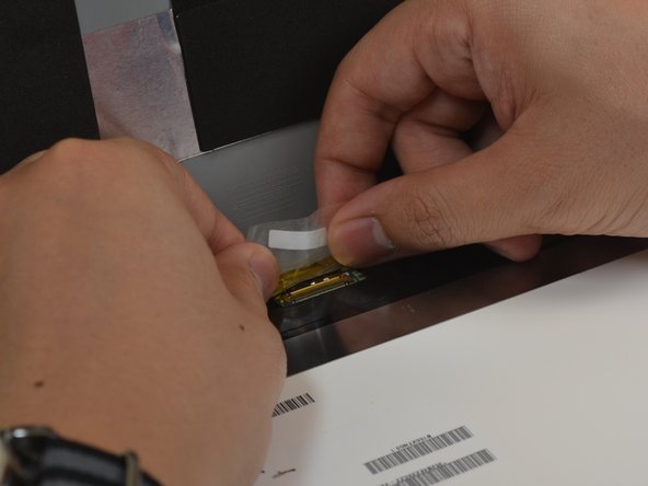

  10. Acer Aspire V5-571P-6815 Touchscreen Replacement: crwdns2935265:010crwdnd2935265:01crwdnd2935265:02crwdne2935265:0 Acer Aspire V5-571P-6815 Touchscreen Replacement: crwdns2935265:010crwdnd2935265:02crwdnd2935265:02crwdne2935265:0
    • Lift the whole strip connected to the circuit board and LCD connector. Place the strip to the side where it is not in contact with the screen.
    • Remove the whole screen from the device.
