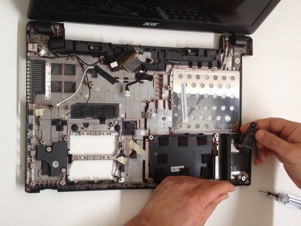

  10. Acer Aspire V5-571 Loudspeakers Replacement: crwdns2935265:010crwdnd2935265:01crwdnd2935265:03crwdne2935265:0 Acer Aspire V5-571 Loudspeakers Replacement: crwdns2935265:010crwdnd2935265:02crwdnd2935265:03crwdne2935265:0 Acer Aspire V5-571 Loudspeakers Replacement: crwdns2935265:010crwdnd2935265:03crwdnd2935265:03crwdne2935265:0
    • Carefully pick up the Mother board and disconnect the Battery cable.
  11. Acer Aspire V5-571 Loudspeakers Replacement, Loudspeakers: crwdns2935265:011crwdnd2935265:01crwdnd2935265:02crwdne2935265:0 Acer Aspire V5-571 Loudspeakers Replacement, Loudspeakers: crwdns2935265:011crwdnd2935265:02crwdnd2935265:02crwdne2935265:0
    • There are two Loudspeakers. Each of them is held by two Phillips screws.
    • Did you do it successfully?
