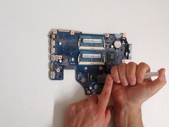

    • Use a lint-free cloth to clean the old thermal compound.
    • If the thermal compound is solidified, you can use a flat end of any plastic tool to scrape it off.
    • Use again cloth with isopropyl alcohol to clean the Thermal surface.

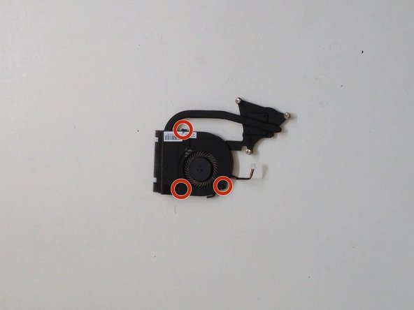

    • Remove three Philips screws held the Fan shield.
  13. Acer Aspire V5-571 Cooling System Replacement: crwdns2935265:013crwdnd2935265:01crwdnd2935265:03crwdne2935265:0 Acer Aspire V5-571 Cooling System Replacement: crwdns2935265:013crwdnd2935265:02crwdnd2935265:03crwdne2935265:0 Acer Aspire V5-571 Cooling System Replacement: crwdns2935265:013crwdnd2935265:03crwdnd2935265:03crwdne2935265:0
    • Unstick the black tape that hold the Fan to the cooler.
    • Unlock the clip and open the Fan case.
    • Use a soft brush and clean the Fan and the Cooler
    • Close the Fan system.

    • Use the same technic to clean the surface of the processor from the old thermal compound
    • Be carefully,if you don't want to break the CPU.
    • Dispense a small amount of thermal compound and gently smear it over the entire processor surface.
