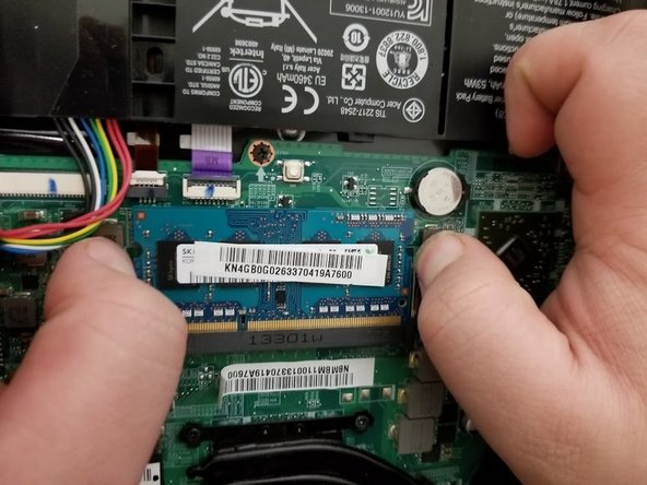

  4. Acer Aspire V5-552PG-X469 RAM Replacement, RAM: crwdns2935265:04crwdnd2935265:01crwdnd2935265:02crwdne2935265:0 Acer Aspire V5-552PG-X469 RAM Replacement, RAM: crwdns2935265:04crwdnd2935265:02crwdnd2935265:02crwdne2935265:0
    • Locate the RAM slot and push outwards on the metal tabs to release the RAM card.
  5. Acer Aspire V5-552PG-X469 RAM Replacement: crwdns2935265:05crwdnd2935265:01crwdnd2935265:01crwdne2935265:0
    • Carefully slide the RAM card out of its slot, and insert the replacement card
