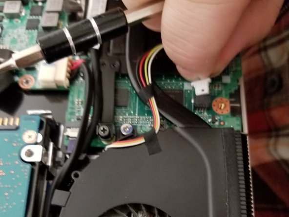

  4. Acer Aspire V5-552PG-X469 Internal Fan Replacement, Internal Fan: crwdns2935265:04crwdnd2935265:01crwdnd2935265:03crwdne2935265:0 Acer Aspire V5-552PG-X469 Internal Fan Replacement, Internal Fan: crwdns2935265:04crwdnd2935265:02crwdnd2935265:03crwdne2935265:0 Acer Aspire V5-552PG-X469 Internal Fan Replacement, Internal Fan: crwdns2935265:04crwdnd2935265:03crwdnd2935265:03crwdne2935265:0
    • Unplug the two multi-colored wires
    • There is one multi-colored wire near either side of the fan

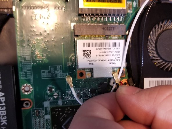

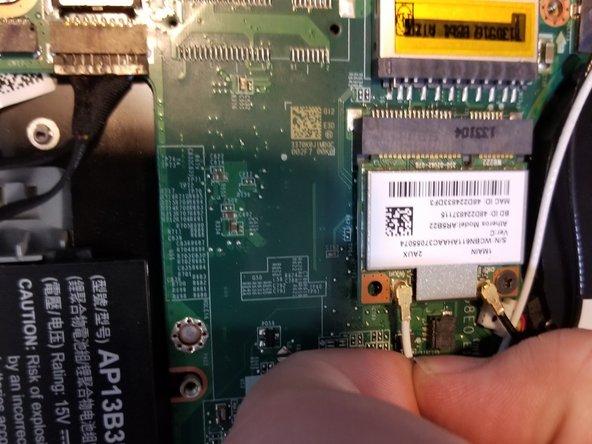

  5. Acer Aspire V5-552PG-X469 Internal Fan Replacement: crwdns2935265:05crwdnd2935265:01crwdnd2935265:03crwdne2935265:0 Acer Aspire V5-552PG-X469 Internal Fan Replacement: crwdns2935265:05crwdnd2935265:02crwdnd2935265:03crwdne2935265:0 Acer Aspire V5-552PG-X469 Internal Fan Replacement: crwdns2935265:05crwdnd2935265:03crwdnd2935265:03crwdne2935265:0
    • Remove the white and the black antenna wires from the wifi module.
