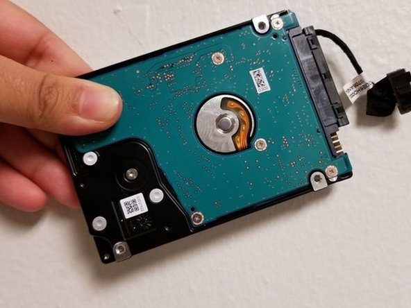

  4. Acer Aspire V5-552PG-X469 Hard Drive Replacement, Hard Drive: crwdns2935265:04crwdnd2935265:01crwdnd2935265:03crwdne2935265:0 Acer Aspire V5-552PG-X469 Hard Drive Replacement, Hard Drive: crwdns2935265:04crwdnd2935265:02crwdnd2935265:03crwdne2935265:0 Acer Aspire V5-552PG-X469 Hard Drive Replacement, Hard Drive: crwdns2935265:04crwdnd2935265:03crwdnd2935265:03crwdne2935265:0
    • First locate the the hard drive as outlined
    • Pull the black bundle cable from its slot by its purple tab
    • Finally, lift and remove the hard drive
