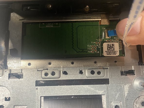

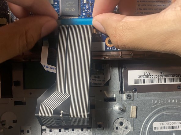

    • Disconnect the two components that are attached to the motherboard and keyboard.
    • The large ribbon cable is disconnected by pulling apart the two white tabs found on each side of the connection and lifting the cable out.
    • The small wire can be removed by simply pulling on the blue tape

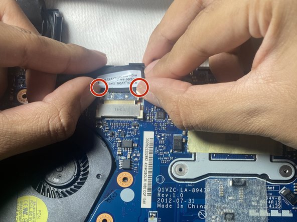

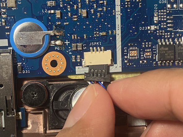

    • Disconnect all the big and small wires connected to the motherboard.
    • The big wires must be squeezed on each side of the connection to release the tabs, then pull the cable out.
    • The small wires can be removed simply by pulling the cable out of the connection
