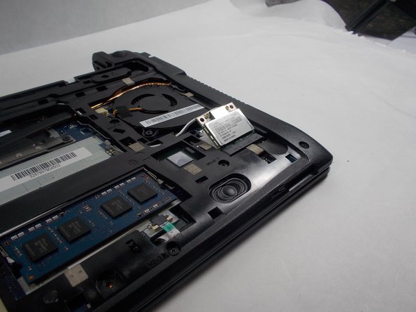

  7. Acer Aspire V5-131-2629 Wireless Adapter Replacement, Wireless Adapter: crwdns2935265:07crwdnd2935265:01crwdnd2935265:01crwdne2935265:0
    • Remove the black and white cables that are attached to the Wi-Fi card.
  8. Acer Aspire V5-131-2629 Wireless Adapter Replacement: crwdns2935265:08crwdnd2935265:01crwdnd2935265:02crwdne2935265:0 Acer Aspire V5-131-2629 Wireless Adapter Replacement: crwdns2935265:08crwdnd2935265:02crwdnd2935265:02crwdne2935265:0
    • Remove the single Phillips screw securing the Wi-Fi card.
    • The wireless adapter will pop out at a 45 degree angle.
  9. Acer Aspire V5-131-2629 Wireless Adapter Replacement: crwdns2935265:09crwdnd2935265:01crwdnd2935265:01crwdne2935265:0
    • Pull on the wireless adapter to remove it and replace it.
