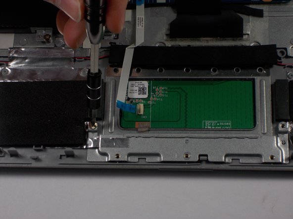

  7. Acer Aspire V5-122P-0889 Touch pad Replacement, Touch pad: crwdns2935265:07crwdnd2935265:01crwdnd2935265:02crwdne2935265:0 Acer Aspire V5-122P-0889 Touch pad Replacement, Touch pad: crwdns2935265:07crwdnd2935265:02crwdnd2935265:02crwdne2935265:0
    • Start by carefully removing the ribbon cable that is plugged into the touch pad.
    • To remove it, gently pull the ribbon cable away from the slot that it is seated in.

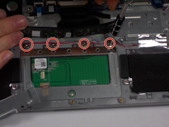

    • Remove the three visible screws below the touch pad that hold the bracket in place.
  9. Acer Aspire V5-122P-0889 Touch pad Replacement: crwdns2935265:09crwdnd2935265:01crwdnd2935265:01crwdne2935265:0
    • Lift and remove the metal bracket from below the touch pad.
  10. Acer Aspire V5-122P-0889 Touch pad Replacement: crwdns2935265:010crwdnd2935265:01crwdnd2935265:02crwdne2935265:0 Acer Aspire V5-122P-0889 Touch pad Replacement: crwdns2935265:010crwdnd2935265:02crwdnd2935265:02crwdne2935265:0
    • Lift and remove the foam-like piece that is located above the touch pad. Note that it is secured by adhesives, and can be reattached after replacing the touch pad.
    • Remove the last four screws that hold the touch pad in place.
  11. Acer Aspire V5-122P-0889 Touch pad Replacement: crwdns2935265:011crwdnd2935265:01crwdnd2935265:01crwdne2935265:0
    • Finally, remove the touch pad from the laptop.
