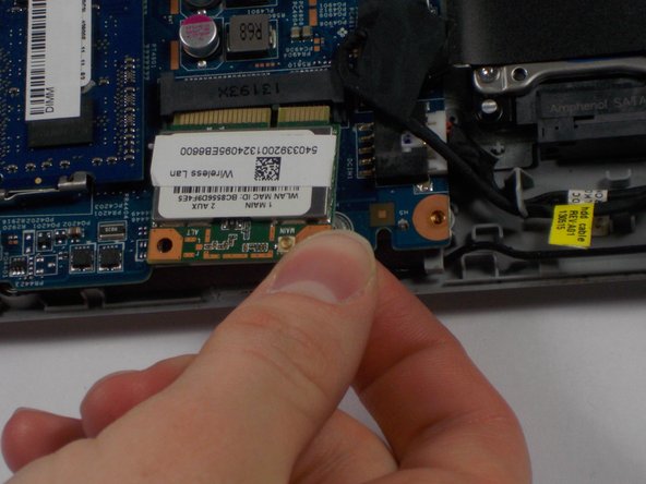

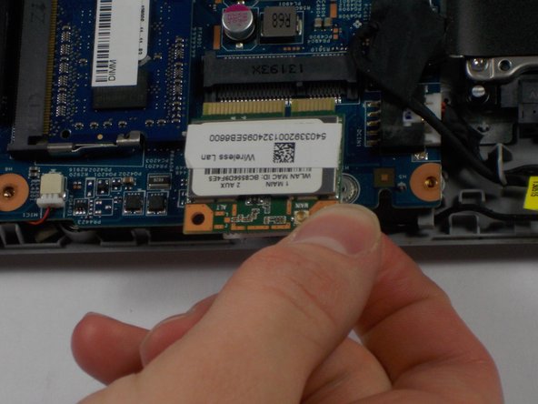

  7. Acer Aspire V5-122P-0889 Network Card Replacement, Network Card: crwdns2935265:07crwdnd2935265:01crwdnd2935265:02crwdne2935265:0 Acer Aspire V5-122P-0889 Network Card Replacement, Network Card: crwdns2935265:07crwdnd2935265:02crwdnd2935265:02crwdne2935265:0
    • Start by removing the antenna cable attached to the network card.
  8. Acer Aspire V5-122P-0889 Network Card Replacement: crwdns2935265:08crwdnd2935265:01crwdnd2935265:01crwdne2935265:0
    • Unscrew the two 3mm screws holding the network card in place.
  9. Acer Aspire V5-122P-0889 Network Card Replacement: crwdns2935265:09crwdnd2935265:01crwdnd2935265:03crwdne2935265:0 Acer Aspire V5-122P-0889 Network Card Replacement: crwdns2935265:09crwdnd2935265:02crwdnd2935265:03crwdne2935265:0 Acer Aspire V5-122P-0889 Network Card Replacement: crwdns2935265:09crwdnd2935265:03crwdnd2935265:03crwdne2935265:0
    • Carefully remove the network card by pulling it backwards, out of the slot that it is plugged into.

Why you should quite battery to take out the wifi card?
Regards
Vibra - crwdns2934203:0crwdne2934203:0
Agreed, no need to pull battery to pull the wifi card, make sure you are ground and you are good to pull and replace.
