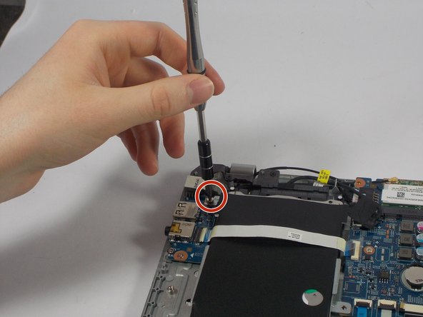

  7. Acer Aspire V5-122P-0889 Hard drive Replacement, Hard drive: crwdns2935265:07crwdnd2935265:01crwdnd2935265:02crwdne2935265:0 Acer Aspire V5-122P-0889 Hard drive Replacement, Hard drive: crwdns2935265:07crwdnd2935265:02crwdnd2935265:02crwdne2935265:0
    • Remove the the two screws that hold the hard drive tray in place.

Man, I know you posted this forever ago, but do you know the size of the screws holding the hard drive in place? I need to replace them.
Even if you never get back to me, thanks for this guide, it was super helpful!
Colin Jaffe - crwdns2934203:0crwdne2934203:0
Step 9 looked different in my case; the colors were just swapped on the motherboard’s cable-connector and I just had to flip upside a tiny black ‘cable-holder/presser’ from the side of the harddisk. @ Colin Jaffe: the size of the screws holding the harddisk-caddy to motherboard are PH1.5 cross, 2mm thick and only 3mm length. BTW: I had only 2 screws attaching the caddy around the harddisk itself (‘diagonally’ positioned) and they were standard-size; 3mm thick, 4mm long, also PH1.5 screwdriver.
