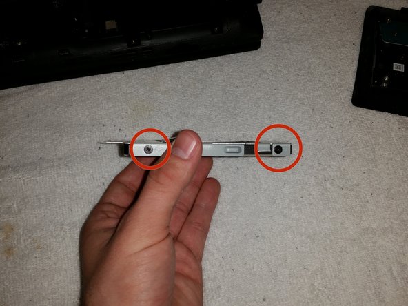

  5. Acer Aspire V3-771G Hard Drive Replacement: crwdns2935265:05crwdnd2935265:01crwdnd2935265:03crwdne2935265:0 Acer Aspire V3-771G Hard Drive Replacement: crwdns2935265:05crwdnd2935265:02crwdnd2935265:03crwdne2935265:0 Acer Aspire V3-771G Hard Drive Replacement: crwdns2935265:05crwdnd2935265:03crwdnd2935265:03crwdne2935265:0
    • Using the screwdriver, remove the four 4 mm screws from the hard drive sled.
    • Carefully remove the hard drive. A new one may now be installed.
