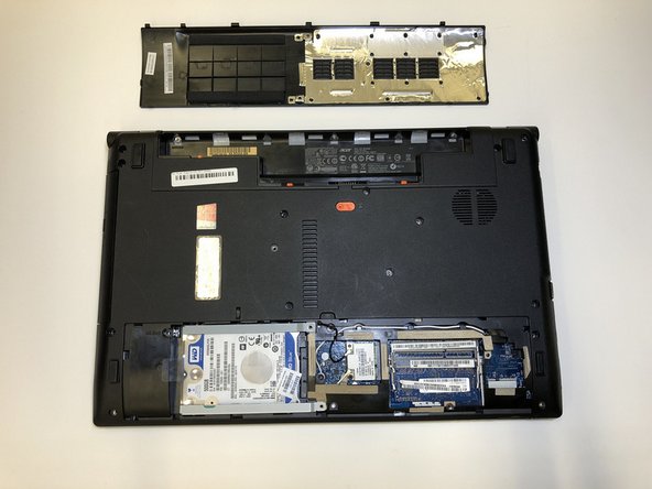

    • To release the battery, slide the orange tab to the right with a spudger.
    • The battery is now released and can be picked up and set to the side.
  2. Acer Aspire V3-551-8469 RAM Replacement: crwdns2935265:02crwdnd2935265:01crwdnd2935265:02crwdne2935265:0 Acer Aspire V3-551-8469 RAM Replacement: crwdns2935265:02crwdnd2935265:02crwdnd2935265:02crwdne2935265:0
    • Remove the two 5.3 mm Phillips #0 screws.
  3. Acer Aspire V3-551-8469 RAM Replacement: crwdns2935265:03crwdnd2935265:01crwdnd2935265:02crwdne2935265:0 Acer Aspire V3-551-8469 RAM Replacement: crwdns2935265:03crwdnd2935265:02crwdnd2935265:02crwdne2935265:0
    • Pull off the back panel.
  4. Acer Aspire V3-551-8469 RAM Replacement: crwdns2935265:04crwdnd2935265:01crwdnd2935265:02crwdne2935265:0 Acer Aspire V3-551-8469 RAM Replacement: crwdns2935265:04crwdnd2935265:02crwdnd2935265:02crwdne2935265:0

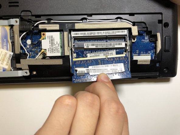

    • Use two plastic opening tools to pry the two clips outward to release the RAM chip.
